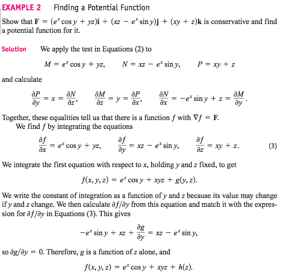

1. The problem statement, all variables and given/known data
When they say therefore g is a function of z alone, I don't understand why.
Also when they integrate the second to the last equation with respect to y, I just want to make sure that the y's in bold cancel, that they're really there in the actual answer
1/y * xzy + e^x cos y

Mentor
Quote by robertjford80 View Post
It says:
"We write the constant of integration as a function of y and z because its value may change if y and z change."
Then they take ∂f/∂y and find that ∂g/∂y =0 . That means that in this case, g does not change if y changes.
Therefore, g is not a function of y.
Taking ∂f/∂z will give you g as a function of z, if indeed it is a function of z. So I suppose that technically, until you do this step, you can't say that g is actually a function of z. Added in Edit: Well, at this point they've changed the name of g(y,z) to h(z) .

May30-12, 02:23 AM   #6
Mentor
As far as I can tell I don't even see what dg/dy refers to, so I can't tell if it is zero or something else. How do you know dg/dy = 0
I can type greek letters with this computer, even when I click on the quick symbols.
The equation
[itex]\displaystyle -e^x\sin(y)+xz+\frac{\partial g}{\partial y}=xz-e^x\sin(y)[/itex]
should tell you that ∂g/∂y =0 .
May30-12, 02:26 AM   #7
Do you agree that [itex]\frac{\partial f}{\partial y}=xz-e^x\sin y[/itex]?
Do you agree that [itex]f(x,y,z)=e^x\cos y+xyz+g(y,z)[/itex]?
Please take the partial of [itex]f[/itex] with respect to [itex]y[/itex] using the last equation.
Relate the two equations to conclude that [itex]\frac{\partial}{\partial y}g(y,z)=0[/itex].
Let us know if this does not clear things up.
(Is it necessary to integrate in [itex]y[/itex] to solve the problem?)

May30-12, 02:43 AM   #9
As far as I can tell dg/dy will always be zero because there is no g anywhere in the problem because the problem starts out with x y z. I don't get what's going on with dg
I will try to suggest where [itex]g(y,z)[/itex] came from.
Do you agree that [itex]\frac{\partial f}{\partial x}=e^x\cos y+yz[/itex]?
If so, use integration to find [itex]f(x,y,z)[/itex].

May30-12, 03:09 AM   #15
Mentor
OK, Now I think we see where you are having difficulty is understanding.
The textbook solution points-out why there is a g(y.z) --- It's the "constant" of integration, but it's only constant in regards to x, not y or z, because your integration is W.R.T. x, treating y and z as if they were constants.

May30-12, 09:37 PM   #17
Mentor
I've given up on this problem. The book only had about 7 problems on these, and I understood about 5 of them, so that's enough to move on.
Let's try the method you used in your more recent thread:
finding a potential function pt 2
You had the partials of f(x,y,z) W.R.T. the variables, from the vector field components.
[itex]\displaystyle \frac{\partial f}{\partial x}=e^x\cos(y)+yz
\quad\to\quad
f(x,\,y,\,z)=e^x\cos(y)+xyz+\text{Some term not containing }x\text{ but including the constant, }C[/itex]
[itex]\displaystyle \frac{\partial f}{\partial y}=xz-e^x\sin(y)
\quad\to\quad
f(x,\,y,\,z)=xyz+e^x\cos(y)+\text{Some term not containing }y\text{ but including the constant, }C[/itex]
[itex]\displaystyle \frac{\partial f}{\partial z}=xy+z
\quad\to\quad
f(x,\,y,\,z)=xyz+\frac{z^2}{2}+\text{Some term not containing }z\text{ but including the constant, }C[/itex]
So by inspection we have that [itex]\displaystyle f(x,\,y,\,z)=e^x\cos(y)+xyz+\frac{z^2}{2}+C\ .[/itex]
I hope that makes more sense to you!
