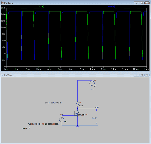

Thanks for the reply. I still don't get it. Ok, let's say I'm using logic gates. What is the independent power source? A capacitor? Uh, I'm really slow. Maybe you can explain in diagrams. I'm sorry for asking too much but I really want to know.

The independent power source could be a battery or voltage from a regulator. The power supply in a PC provides a constant set of DC voltages that power all the logic in your computer.
I attached one of the most simple ways to make an inverter. The inside of an inverter gate might look like this, but this is more simplified.
V2 is the independent voltage source. It is a constant 15V and can provide as much current as the circuit tries to pull from it.
The input is a digital pulse high-low-high-low-etc. and because the switch is a MOSFET, it requires little charge to turn on (so no current goes into it). When the MOSFET is off, the current through the resistor R1 has no where to go, and so it has no voltage drop across it, so the V2 voltage will be present at VOUT. When the switch is turned on, current can flow through R1 to ground, and so the voltage is dropped across R1, and VOUT is switched to ground.

A power supply, connected to the NOT gate. A real NOT gate has 4 connections:
2 you care about in circuit designs:
- data input
- data output
And 2 you need for operation:
- "plus" and "minus", connected to a power supply
Here is an example. A and Q are the input/output, and Vdd and Vss are powering the thing.

That is a more abstracted drawing that you attached. It is not the detailed hardware implementation, but rather a logic schematic. Similar to drawing a voltage source without showing how that voltage source really works.
