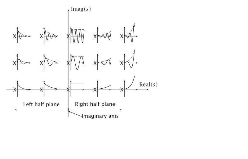

Why oscillations occur in transient response of a system ?
Suppose transfer function of a system is 1/(s+1). Then its impulse response will be c(t)=e[itex]^{}-t[/itex] . So why just we don't show only an exponential curve to graphically represent the impulse response, why we also show the oscillations ?

please see the attachment
in all the transient responses , the dashed curves show the actual time dependency of the output signal and solid curves show the oscillatory behavior . My question is this in studying control system when we have to judge the stability of the system we use the oscillatory behavior , but why is there an oscillatory behavior ?
We solved for the output of the system mathematically and got the output of the system in time domain as in example below , then how the oscillations come ?
Then its impulse response will be c(t)=e^(-t) . So why just we don't show only an exponential curve to graphically represent the impulse response, why we also show the oscillations ?
The simple (and kind of obvious) answer is that not all systems have transfer functions that are as simple as your single pole example.
If it's a second-order or higher order system, then it can overshoot & oscillate, depending on damping.

sorry i posted wrong. c(t) is [itex]e^{-t}[/itex] . and no sin term
the graph of c(t) is simply decaying exponentially , then why do we show oscillations. I mean mathematically i showed that c(t) is just decaying exponential , and there is no sin term. So tell me where i am missing ?
The other curves you are showing are not described by the transferfunction
[itex]X\left(s\right) = \frac{1}{s+1}[/itex]
When you convert that particular transferfunction back to the time-domain, yes, you have an exponential.
But if you are dealing with a 2nd Order System then your system could be described by the differential equations:
[itex]y(t) + A\cdot y''(t) + B\cdot y'(t) = C\cdot x(t)[/itex]

It will have two roots s1 and s2. When you know the roots it is possible to factorize it into
[itex]H(s) = \frac{C/A}{(s-s1)(s-s2)}[/itex]
Now these roots can be in three different formats:
1. Two distinct real roots s1 and s2
2. A double real root s1
3. Two complex-conjugate roots s1 and s1*
IF it happens that the roots are COMPLEX, when you go back to the time domain by doing the partial fraction expansion, you will find that you will get sines and cosines.-
And that is where the oscilations come from.
Now when are the roots complex? - It depends on the coefficients A, B and C.

in books they took a first order system , calculated its response in time domain by using the inverse laplace of system function and got an decaying exponetial curve. Then they plot the exponential curve and marked the oscillations in that curve and said that " as the oscillations are decreasing , the system is stable". OK i know that in that particular impulse response if there are oscillations then they will die after sometime. But why there are oscillations ?
If the book is talking about oscillations in a first order system the book is wrong.
Oscillations only happen in higher order systems. (2nd and above) due to the facts I stated in my last reply.
Mathematically the oscillations in higher order systems happen because of complex poles of the transfer function (roots of the polynomial in the bottom of the fraction). These complex poles are present because of the way the coefficients are chosen.
I don't know what to say other than that. That IS the reason why there is oscillations.
