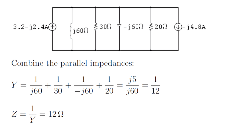

I need to find the total impedance in a circuit that has:
j60 ohms, 30 ohms, -j60 ohms and 20 ohms in parallel
Ztotal=1/(Z1+ Z2+ Zn)
I've tried doing this, but what I think is the -j60 and the j60 should cancel therefore leaving only the 30 ohms and 20 ohms in parallel, which would equal 1/50, but the answer says it is 12 ohms.
Attached is an image of the circuit and answer.

So then, 1/30 + 1/20 = 1/50 ? Check your math.
Parallel impedance is:
Ztotal=[1/(Z1+ Z2+ Zn)]^-1
Also remember when adding fractions you must have a common denominator.
For example 1/a + 1/b = (a+b)/ab
but how does that j5 get up there?
To be honest i think that's a mistake. The negative and positive j components cancel out. That should say 5/20 not j5/j20 even though those two ratios are equivalent.
