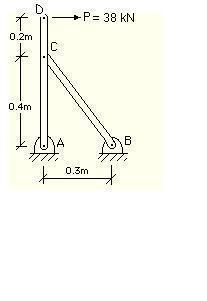

For the frame shown (see attached picture) , work out the horizontal reaction at B (ie find Bx)
EQUILIBRIUM EQUATIONS:
sum of moment = 0 (CCW is positive)
sum of vertical forces = 0 (up is positive)
sum of horizontal forces = 0 (left to right is positive)
I thought this was easy but for some reason everytime I equate the forces, Bx gets canceled out.
[sum of moments at A = 0];
-38(0.6) + By(0.3) = 0
By = 76 kN
[sum of moments at B = 0];
-Ay(0.3) + 38(0.6) = 0
Ay = 76 kN
[sum of moments at D = 0];
Ax(0.6) + Bx(0.6) + By(0.3) = 0 (***)
[sum of moments at C = 0];
(-38)(0.2) + Ax(0.4) + Bx(0.4) = 0
so, Ax = 19 - Bx
substitute Ax = 19 - Bx in (***) :
(19 - Bx)(0.6) + Bx(0.6) + By(0.3) = 0
but By = 76 kN so:
(19 - Bx)(0.6) + Bx(0.6) + 76(0.3) = 0
BUT Bx just cancels out??
I have no clue how to approach this question any other way
Any help/guidance would be great!
Thanks!

I got it :)
I realized that when taking the moment about C, the force Bx does not need to included.
So Bx = -57 kN
NO. By produces a moment also.
Kasthuri said:
I got it :)
So Bx = -57 kN
What you mean to say is that since member BC is a 2-force member with the force BC directed along the axis, then the force BC produces no moment about C.
Thanks for that PhanthomJay! :) My exam is very very soon and I'm glad you cleared that up for me.
