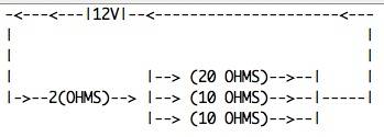

The problem involves a circuit with a 12 Volt source connected to a 2 Ohm resistor, followed by a parallel arrangement of resistors: one 20 Ohm and two 10 Ohm resistors. The goal is to determine the power dissipated by one of the 10 Ohm resistors.

This was a diagram, so I will describe it as accurately as possible.
[Edit]:
12 Volts go through one 2 Ohm resistor which then proceeds through a set of resistors in parallel. One is 20 Ohms, the other two are 10 Ohms.
How much power is being dissipated by one of the 10 Ohm resistors?

Can I calculate the Current after the first resistor using V = I * R ? If so, I know how to calculate the total resistance by using 1/R = Sum of (1/Rn). Would the resistance of one resistor just be 1/R = 1/10 --> R = 10?

Btw, is this your circuit?
Yes, that is my circuit. When I first viewed it was completely illegible, so I just deleted it. Could have been a rendering error so thank you for correcting that for me.
You say that I must know the values of I and R. Well by V = IR I should be able to calculate this: 12V = I*(2 Ohms), I = 6A. Is this not the current directly after the first resistor?

No because that 12V is applied across the 2 Ohm resistor *and* the parallel combination of three resistors.

Any parallel set of resistors has the same voltage applied across them. This means the total current through the parallel set can be found by adding V/R of each resistor. If you then look at the voltage applied (V) and total current through the parallel resistors (sum of all V/R), a relationship is found between V and total current through the parallel branch: V/I = 1/(1/R1 + ... + 1/Rn). This looks like Ohm's Law with an effective resistance of 1/(1/R1+...+1/Rn). This means you can *replace* your parallel set of resistors with a single resistance without affecting the rest of the circuit. Further, the current you find in this replacement resistor will be the total current through the parallel resistors. You can determine how that current divides between the resistors from their resistance ratios.
The same can be done with series resistances, with the key insight being the same current that flows through one resistor must also flow through a series resistor in order to get from point A to B.
Your homework problem is then to transform your relatively complicated circuit into a simple one of one resistor connected to a battery to find the circuit current and then work from there by unravelling the circuit transformations you made to compute currents and/or voltages across the original resistances that were made part of the effective resistances in the simplified circuit.
