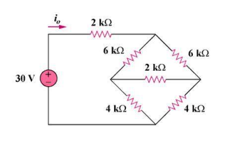

Hello,
This is a little basic I know, but I'm a little confused on how I would calculate the total resistance for this circuit... this circuit was actually to find I0 using mesh analysis, but I was trying to figure out the resistance to obtain I0 using ohms law. I am not sure how to incorporate the 2kΩ into the calculations.. (I was thinking it was something like 2+(((6||6)||2)||(4||4)) )
Can anyone help?
Thanks!

Yes it was homework, The actual question was "For the bridge network, find I0 using mesh analysis."
The actual solving of this was pretty straightforward, solving 3 simultaneous equations to obtain i0 = i1 = 4.286 mA using KVL.
But my question was how to analyze the resistors in this configuration- and removing the 2k would mean the overall R is reduced... so from V = IR, the current would be reduced?
I realized after that there are two 2k resistors.
So I am referring to the one across the "bridge" formed by the 6k and 4k resistors.

Clearly the resistance load experienced by the 30 volt source is given by 30/i0.
You have correctly calculated i0.
Now to understand this circuit what is the current through the 2k resistor across the bridge and why?

I'm not too sure what the current is across the 2kΩ resistor on the bridge... would it be 0, since the current perhaps bypasses it? :confused:

Let us call the 2k resistor R6.
Now R6 can be any value you like and it will make no difference to the result since there is no current in it.
There is no current in it because both ends are at the same voltage. ie there zero voltage across it.
That is why I originally suggested you remove it, since it actually plays no part in the circuit.
If we remove it you have two branches comprised of a 6k in series with a 4k fed from the same voltage nodes.
So the resistance of this is (6k+4k) || (6k+4k) = 5k.
This is in series with the first 2k resistor call it R1.
So the total resistance = 2k + 5k = 7k
So i0 = 30/7000 ≈ 4.5 mA as you calculated.
Can you follow this so far?
Ah right! The potential difference is 0.. Completely forgot about that :blushing:
Yeah it totally makes sense now. Thanks for walking me through it!
