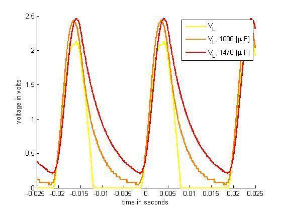

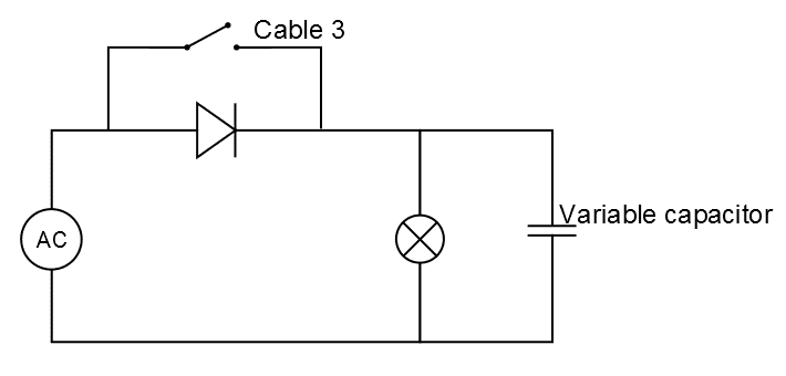

I have s issue concerning rectification of a sinusoidal voltage with a diode. It is a experiment i am doing.
The case is a 1N4001 diode in series with a lamp and a capacitor in parallel to the lamp. The circuit is supplied by a sinusoidal voltage with a rms value of 2.2 V.
The set up can be seen on the attached file called "Half_wave_rectifier". (The switch is open so the diode does not get bypassed).
On the attached file called "HalfWaveV_L" is 3 graphs showing the voltages of the lamp. The yellow is with zero capacitance and the orange and red is with the capacitances drscriped at the figure.
My first question is why the wave has higher peak values with capacitors than without a capacitor? To that comes why the wavetops for the yellow graph is apruptly cut of, compared to the round tops of the orange and the red graph.
I have also measured the rms current in the circuit for the various capacitances, and it gets bigger the bigger the capacitance is. I can't understand why that really is. The peak values of the voltage increases with the capacitance, so that kind of explains it, but then again, why does the peak values grow?
The rms currents meassured was 0.26 A for the yellow graph, 0.4 A for the orange graph and 0.41A for the red graph.

Interesting result. How did you measure voltage and current?
The yellow graphs follows the power supply - probably similar to a sine wave (minus some offset for the diode).
No, as the additional current is needed to charge the capacitor. It discharges itself via the lamp when the power supply is at a negative voltage.
One guess: The capacitor increases current and therefore the average load of the lamp - it gets hotter, and its resistance might increase. If the power supply is not perfect and its voltage depends on the current, this might lead to a higher peak voltage. I would not expect this, but something has to explain your observations and I don't see anything better at the moment.
Firstly I assume you voltage axis is measuring the voltage across the lamp (and capacitor).
OK so the yellow curve is a poor quality half wave rectified waveform.
When the capacitor is in circuit it charges to the peak value of the voltage (or nearly so depending upon the available current). this will be the true peak not properly shown by your yellow curve.
The part of the orange and brown curves that you see in the part of the cycle when the diode is non conducting show the classic exponential discharge curve for the capacitor through a resistor (the lamp).
The capacitor is releasing its stored charge through the lamp and the curve shows that it has the same polarity as the rectified supply - which is what you would expect.
Note also that the smaller capacitor shows a deeper discharge - the curve coming coloser to zero.
Why is does the yellow curve not reach to the true peak? asking, not arguing here.

The 2.2 Voltage (rms value) which I imentioned was measured with a multimeter over the terminals of the power supply. The current was measured also with a multimeter but ofc. in connected in series.

Yer, the graphs on the figure is the voltage across the lamp and capacitor. And it is measured with a osciloscope.

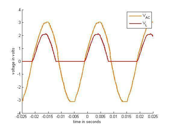

Attched is two graphs. The orange graph is of the voltage from the power supplied which was measured while the circuit was conencted. (It was measured with the osciloscope, and over the terminals of the power supply). And the red graph is the same as yellow before. (the voltage over the lamp, where no capacitor is connected).
Maybe this can help with something.
This graphs reminds me of another problem: the red graph is slightly shiftet compared to orange one. How can this be?

The difference in height of the orange and red peaks on your new graphs corresponds to the forward voltage drop across the diode.
Yes the capacitor introduces a phase shift.
Yes the current will increase with capacitance, a capacitor represents an AC load in parallel with the lamp.

I think the height of the yellow peak (from its start value) is about the same as for the other curves. The finite 'on' resistance of the diode will be limiting the amount of charge that can flow during the conducting period so the peak output volts can only increase by so much in that time. The measured voltage 'sits on top of' the value which is stored in the reservoir capacitor. Would the 'diode voltage drop' not be the same when the diode starts to conduct - in all three curves?
The rms current is higher with a reservoir capacitor because the average (height squared) of the voltage curves is greater (it's on for longer). If you had a 1F capacitor, the volts would be high all the time - the only factor to reduce the available volts would be the source resistance of the upstream circuit.
There is a significant difference between the the lowest value achieved (=start value?) of the brown curve compared to that of the red curve, in fact the brown minimum is closer to the yellow minimum that the red minimum. Yet its maximum is pretty well the same as the red curve.
How does it get smaller with capacitor then?

Yes, you're right about the brown curve. The brown curve drops faster than the red - as you'd expect and the brown curve starts rising very near to the yellow. The yellow curve has a flat top - perhaps indicating current limiting. But the diode handles 1A (spec sheet) so that shouldn't be a problem. Is the AC source limiting at a low value of current - but even that should give a slope at the top of the yellow curve. Does all this happen with different diodes and power supplies?
