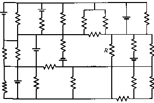

In the figure provided, all the resistors have a resistance of 4 ohms and all the ideal batteries have an emf of 4 V. What is the current through resistor R?
This question had me baffled for a while, I can't quite trace through the circut. Even my physics teacher got lost with the unbelievable loops in the circut. Any help would be greatly appreciated!

ANYONE? Come on, this can't be that hard.
I think it's 2A.
Use Kirchoff's Voltage Law.
Start at the junction below the lower-left battery.
Travel up to the upper left corner, passing along three batteries along the way.
Then travel right to the battery near the right-side, passing it "backwards".
Then travel to your resistor, then down to the bottom wire, which is
equivalent to your starting point.
(+4V) + (+4V) + (+4V) + (-4V) + (-IR) = 0
or
(+8V)=IR... so I=(8 V)/R = (8 V)/(4 ohms)= 2A.
Aha! I knew there had to be a trick! Here I was starting to set up a 19 x 19 matrix. After bogging down in all the junctions I thought I'd just wait for the answer to show up. So, to summarize: find a loop that only passes through the batteries and the resistor that you want, eh? Brilliant! I love it!
