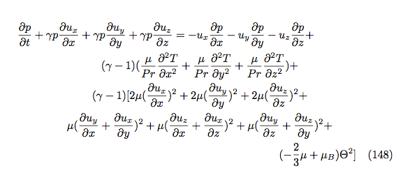

Hi all,
I derived the energy equation for compressible flow in terms of pressure p from the governing equation in terms of the total energy density e (using the perfect gas assumption and assuming constant viscosity), but I am not sure if I did it correctly. I post it here, please tell me if it's right, or suggest me some useful references I could consult. Thanks a lot!
Jo
Anyone could help me?
Thanks!
Jo
