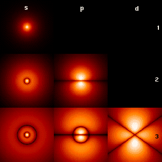

The picture shows the first few hydrogen atom orbitals (energy eigenfunctions). These are cross-sections of the probability density that are color-coded (black=zero density, white=highest density).according to the picture -Do s orbital electrons have highest probability density in the nucleus?
(i am totally new to quantum mechanics.So please tell if i am wrong.)
If you take the radial part of the wave function only, then yes, the probability density ##|\psi|^2## is maximum at ##r=0## for s electrons. But that doesn't mean that the expectation value ##\langle r \rangle## is 0. A measurement will most likely find the electron at a certain distance from the nucleus.
Another way to see it is to consider the radial distribution too. As s orbitals are spherical, the surface of the sphere increases as ##r## increases, so the probability of finding the electron at a certain distance of the nucleus goes through a maximum away from the nucleus.
