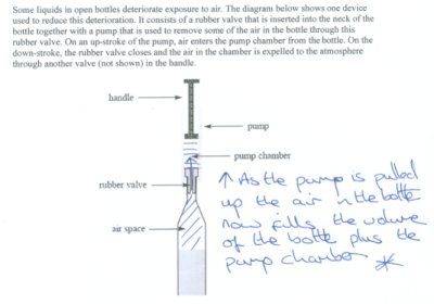

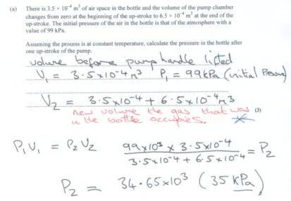

At constant temperature
then P1V1=P2V2
This is my attempt at the solution
however the mark scheme says
Any help appreciated?
I just can't see what I am not seeing?
I think there is a typo in the question. The volume in the bottle is much greater than the volume in the pump chamber in this diagram. I suspect that the questioner intended the volume of space in the pump chamber to be 6.5 x 10-5 m3 (.065 l). If that were the case, the given answer is correct.
AM
Andrew your a star, I would never have seen that.
Thanks again for your help
