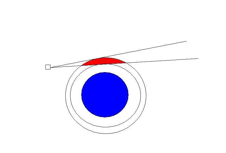

Are you assuming a right-circular cone? with finite height?
Are you assuming that the conical axis is radial?
Is the vertex inside or outside the sphere?
A probably not-so-pretty case ["for an arbitrary cone and a sphere"] is a cone with an exterior vertex whose axis is a secant line almost grazing the sphere.
Plz see the attachment. This is a radar which orbits an earth. I am interested in the area marked in red color. You have to picture it in 3d plus the sattelite signal changes heights as it moves around Earth as it scans up and down (but we could omit that for now). I just need some lead on the math involved...
thanx for help
