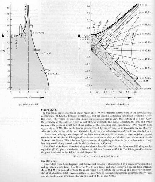

Here's one of the diagrams from Gravitation, showing the surface of a collapsing star (the black line bounding the gray area which represents the inside of the star) in both Schwarzschild coordinates and Kruskal-Szekeres coordinates. They've also drawn in bits of light cones from events alone the worldline of the surface, and the event horizon is shown as a vertical dotted line in the Schwarzschild diagram on the left, while it's shown as the line labeled r=2M at 45 degrees in the Kruskal-Szekeres diagram on the right (the sawtoothed line in that diagram represents the singularity).

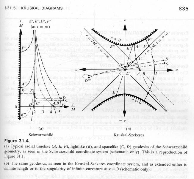

Here's another diagram from p. 835 of Gravitation, showing schematically how various paths through spacetime--timelike, lightlike, and spacelike--would look when plotted in both Schwarzschild and Kruskal coordinates. The Kruskal-Szekeres diagram here represents the "maximally extended" version of the Schwarzschild spacetime, which in addition to the exterior region and the black hole interior region also contains a white hole interior region at the bottom and an exterior region in "another universe" at the left--there was a thread discussing the meaning of this maximally extended solution, along with Kruskal-Szekeres diagrams in general, here.

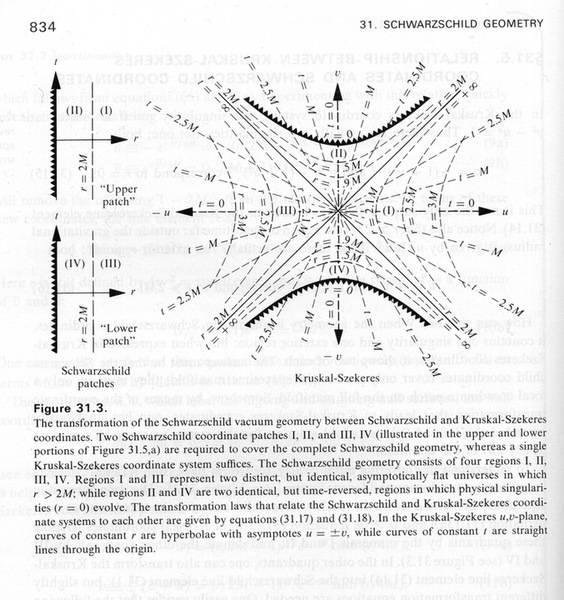

Finally, here's a diagram from p. 834 which shows how lines of constant radius and constant time in Schwarzschild coordinates look when plotted in Kruskal Szekeres coordinates--you can see that lines of constant Schwarzschild radius look like hyperbolas, while lines of constant Schwarzschild time look like straight lines at different angles. Note that the Kruskal diagram is divided into four regions bounded by event horizons at 45 degrees, regions I (our universe, outside the horizon), II (inside the horizon, black hole region), III (another universe, outside the horizon) and (IV) (inside the horizon, white hole region), this having to do with the "maximally extended solution" I mentioned above.
Austin0 said:
I got that light speed was uniform going into or away from a nonrotating BH but remained unsure if this also meant a uniform time metric throughout the gradient or whether this coordinate system was applicable under less extreme conditions.
Not sure what you mean by "uniform time metric throughout the gradient". The Kruskal-Szekeres system is just a different coordinate system on the same physical spacetime, so all physical predictions about coordinate-invariant things will be the same as if you used Schwarzschild coordinates. For example, if you have two clocks hovering at constant Schwarzschild radius above the horizon, then regardless of what coordinate system you use, you should get the prediction that the clock at greater radius sees the clock at smaller radius ticking more slowly than itself (and if one member of a pair of twins on the farther clock takes a journey to the closer clock, stays there a while, then rejoins his brother on the farther clock, he will now be younger--gravitational time dilation).
