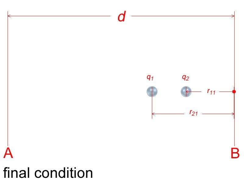

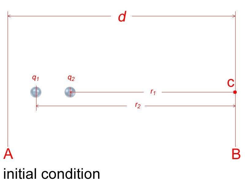

Hi all,
Here is my problem:
Two positive points charges are situated as the initial figure:
1/ How to compute the voltage between A and B (or C)?
2/ If the final condition is like described in the second figure, what is now the voltage between A and B.
3/ if the transition between the two states takes a time t1, does the speed of this transition changes something about the voltage that exists between A and B?
Thanks.
  • Diagram of two positive point charges q1 and q2 on a horizontal line between points A and B, with point C marked near B, distances r1 (q2 to C) and r2 (q1 to B) and total separation d labeled, captioned initial condition.
  • Diagram of the final condition: vertical line A at left and line B at right separated by distance d, with charges q1 and q2 as spheres near B, and distances r11 from q2 to a point on B and r21 from q1 to B.

Ah, no, it doesn't really work that way. For example, the potential at point B due to charge q1 alone would be
k q1 / (distance from q1 to B)​
However, I am looking at the figures more closely and some things are confusing me:
1. You have used r2 to refer to the position of q1. Did you mean to mix the subscripts like that? It is confusing to do so, but we can go with that definition if that is what you intend.
2. Do "A" and "B" refer to points along the line joining the charges? It would make sense if they do, but then point "C" would be the same as point "B" in your first figure.
there is an error in the figure. r1 was meant to belong to q1.
and r2 to q2.
Yes.

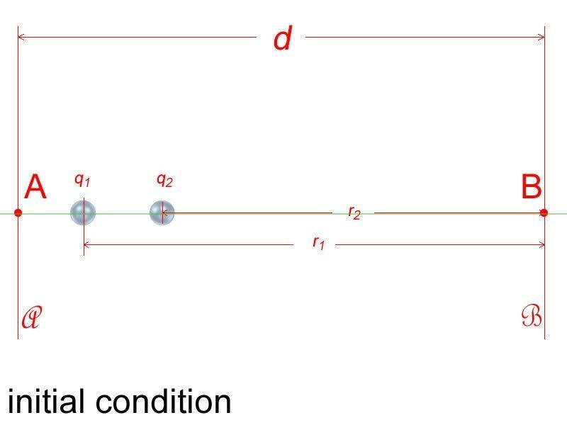

Okay, thanks.
So, if you just had charge q1, the potential at B would be
k q1 / r1​
But you also need to add the potential due to charge q2, so you'd have
VB = (k q1 / r1) + ____​
Then you'd do the same thing for VA, the potential at point A.
VB = (k q1 / r1) + (k q2 / r2)
VA = (k q1 /(d-r1)) + (k q2 /(d- r2)) ?
Yes, that's right.
And the voltage between A & B would be VA-VB ... or VB-VA, depending on whether A or B is being used as the reference point.

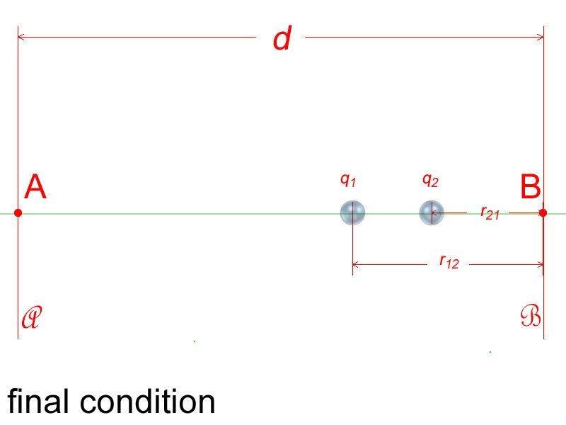

I made new pictures:
Hope they are more accurate.

somasimple said:
I thought there was a current since there is a voltage but and I'm certainly wrong.
There would have to be some type of conductor joining A and B for there to be a current.
Looks good, that more accurately depicts the situation you are describing.
