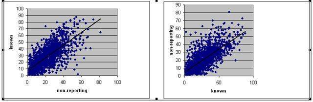

Here are two Excel displays showing all the data. Note the different slopes of each graph.

To me, the simplest approach is assume the equation: Y = 0.59 X + 5 + u
You can compute the data from the u by subtracting the actual value from the predicted value. Then you can plot the distribution of the u (or run some statistical tests on it) to see if it looks like a normal distribution with mean zero and some variance (which you can also estimate).
If u is a normal distribution, then given any X (= a station 2 measurment) you can compute the probability that Y is in any given numerical range of interest using the theory of the normal distribution.
The regression like you would get by reversing X and Y is not relevant to predicting Y given X. I look at it this way: The probability of Y given X need not be the same as the probability of X given Y. The mean value Y_m of all the Y's that are paired with a value of X = X_0 need not be the same as the mean value of all the X's that are paired with a Y = Y_m.

Thank you for your help. I admit am having a difficult time understanding the concept. To me, if the speed I need to keep my eye on (when the wind most likely is 50KT at the unknown station) is when the real wind is 76KT at the known one, then in a real world situation one would think that if one was standing at the unknown station and the wind was measured with a temporary anemometer at 50KT, then the wind would most likely be 76KT at the other "known" one... but, these formulas don't show that. They show that if 50 at unknown, then the known one is only 55KT not 76KT.
I want a result that will give me an answer like 50 at the unknown when 66 at the known, and vice versa, when 66 at the known it is 50 at the unknown. That would make my brain happier.
How do I find this relationship?
I am trying to see this from the perspective indicated in the second paragraph. Mathematics be damned! I need a real world visualization!
