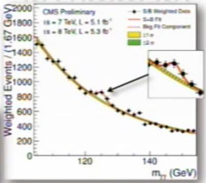

CMS presented a 4.9sigma-signal using the 3 sensitive channels.
The H->gamma gamma channel is very convincing (with a significance of 4 sigma), here is the summary plot for this channel:
CMS Preliminary plot of weighted events per 1.67 GeV against m_gamma gamma (GeV) for 7 TeV (5.1 fb-1) and 8 TeV (5.3 fb-1) data, with black data points, a red S+B fit, a dashed background fit, and yellow and green uncertainty bands; an inset zooms in on a small bump near 125 GeV.
Result from the conference:
They observed a new boson with mass of 125.3 ± 0.6 GeV at 4.9[itex]\sigma[/itex] significance.

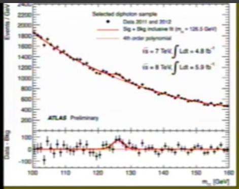

Edit: Here is the corresponding ATLAS plot, giving (local) 4.5 sigma in the H->gamma gamma channel.
ATLAS diphoton invariant mass plot showing data points, a 4th order polynomial background fit and signal-plus-background fit near 125.5 GeV, with a residual panel below showing a small bump near 125 GeV.
