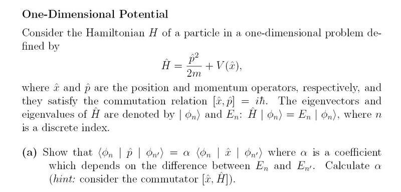

As a group we're stuck on this as a result of the lecturer saying that he wouldn't help us because we should work as a group and find other ways other than asking him about it. Which is fair enough - but none of us understand what's going on!
So far I have tried substituting in for p in the middle of the bracket with -ihd/dx and then used the commutation relationship to try substituting ih for xp - px, but this seems to leave me being nowhere.
I also tried starting with the bracket having H in the middle and substituting for that - this kind of left me with a bracket with p in the middle and one with x in the middle, but whilst this kind of left things in a format that almost looked correct the two brackets were not equal to one another, only additive.
Could anyone suggest a starting point to look at or just any other helpful information that I may have missed when rereading my notes.
Well, have you calculated [x,H]?
Then you can calculate <n|[x,H]|n'> in two different ways: equating the two answers gives you the desired result.
No I hadn't - I thought that was to do with the second part of the question.
I shall give that a go now!
