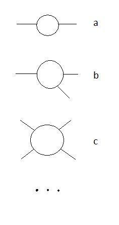

When I want to draw all the 1-loop 1PI diagrams, should I make something like these:
In general yes. The [itex]\phi^3[/itex] theory admits 3-particle vertices. However, it always depends on what kind of correction you want to compute. For example, if you are interested in the propagator (2-point function) then you will consider the diagram a. If you are interested in a 3-particle interaction you will consider b and so on.
