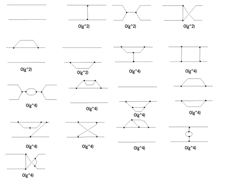

I have some difficulty understanding how to go about with this problem:
For a scalar theory whose interaction part is [itex]\frac{g}{3!} \phi^3[/itex], draw all connected graphs up to one-loop approximation contributing to the process [itex]\phi (k_1) \phi (k_2) \rightarrow \phi (k_3) \phi (k_4)[/itex].
I came up with several graphs, you can see them in the attached picture (they are up to ~g^4 order). I am not sure about the self-interaction diagrams, but I think they are considered in the connected graphs (they are not away from the external legs).
To order [itex]g^2[/itex] show that the relevant correlation function is the product of the external leg propagators times the amputated Green's function. What are the graphs of the amputated correlation function ?
I am not sure whether here I'll have to also include the g^2 self-interacting graphs... without them I seem to be getting:
[itex]G \sim g^2 \Big( \frac{1}{s+m^2} + \frac{1}{t + m^2} + \frac{1}{u+m^2}\Big) \delta^4 ( k_1 + k_2 - k_3 - k_4)[/itex]
which looks OK compared to also including them.
  • Grid of twenty-one Feynman diagrams drawn as horizontal lines with vertices, some labelled O(g^2) and others O(g^4), including exchange, self-energy loop and vertex-correction topologies.
By "self-interacting" you mean e.g. the first two in the second row? You are supposed to only consider connected graphs, so these two (and the very first one, and also some later ones) should not be there in the first place.
Also, I think there are more diagrams at 1-loop, e.g. more self energies and tadpoles...
I thought connected graphs were those that didn't have loops away from the internal/external legs (contributing to vacuum, which cancels out).
hmm, maybe
At least in the conventions I am aware of, "connected" means that all external lines are connected to each other. A better definition might be something like "momentum conservation is not fulfilled by a subset of external momenta". These are the ones that actually give a contribution to the T-Matrix.
