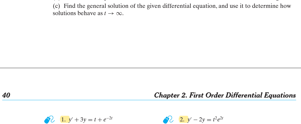

Find the general solution of
$y'−2y=t^{2}e^{2t}$
and use it to determine how solutions behave as
$t \to \infty$
ok presume the first thing to do is to find $u{x}$
$\exp{\displaystyle\int{2} y}=e^{-2} or \dfrac{1}{e^2}$
is the DE
$y' - 2y = t^2e^{2t}$ ?
if so, then the integrating factor is $\mu = e^{\int -2 \, dt} = e^{-2t}$
$e^{-2t} \cdot y' + (-2e^{-2t} \cdot y) = t^2$
$(e^{-2t} \cdot y)' = t^2$
$e^{-2t} \cdot y = \dfrac{t^3}{3} + C$
$y = e^{2t}\left(\dfrac{t^3}{3} + C\right)$

y- 2y? That's equal to -y! Do you mean $y'- 2y= t^2e^{2t}$?
You say "the first thing to do is find ux". That makes no sense because there is no "u" or "x" in the problem!
I presume you mean you are looking for an "integrating factor". That would be a function, u(t), such that u(t)y'- 2u(t)y= (u(t)y)'. Since (u(t)y)'= u(t)y'+ u'(t)y we must have u'(t)y= -2u(t)y so that u'(t)= -2u(t). Then u'(t)/u(t)= -2. Integrating, ln(u)= -2t+ C and $u(t)= C'e^{-2t}$ where $C'= e^C$.
Multiplying both sides of $y'- 2y= t^2e^{2t}$ by $e^{-2t}$ (since we can use any integrating factor we can take C'= 1) we get $e^{-2t}y'- 2e^{-2t}y= (e^{-2t}y)'= t^2$.
Integrating both sides $e^{-2t}y= \frac{1}{3}t^3+ C$ so that
$y(t)= Ce^{2t}+ \frac{1}{3}t^3e^{2t}$.

yes my bad #2
