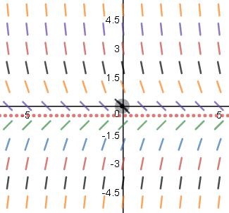

$y'=-1-2y$
$\begin{array}{ll}
rewrite &y'+2y=-1\\
exp &u(t)=\exp\ds\int 2 \, dx=e^{2t}\\
product &(e^{2t}y)'=-e^{2t}\\
&e^{2t}y=\ds\int -e^{2t} \, dt=\dfrac{-e^(2 t)}{2}+c\\
hence &y(t)=\dfrac{-e^{2t}}{2} + \dfrac{c}{e^{2t}}\\
t \to \infty &=-\dfrac{1}{2}+0\\
so &y \to \dfrac{1}{2}\textit{ as t} \to \infty
\end{array}$
ok this is an early problem but probably some comments to make it more understandable
hopefully correct
I was going to try tikz on this but probably 3 pages of code so its a desmos templatehttps://dl.orangedox.com/geAQogxCM0ZYQLaUju
