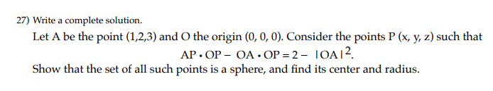

$\textsf{Write a complete solution.}\\$
$\textit{ok Let A be the point (1,2,3) and O the origin (0, 0, 0). }\\$
$\textit{Consider the points P (x, y, z) such that AP · OP − OA · OP = 2 − |OA|2.}\\$
$\textit{Show that the set of all such points is a sphere, and find its center and radius.}\\$
ok, will be dealing with this in the morning
but would like some suggestions?
Re: 243.12.5.27
I would begin by expressing the given directed line segments in component form:
$$\vec{AP}=\left\langle x-1,y-2,z-3 \right\rangle$$
$$\vec{OP}=\left\langle x,y,z \right\rangle$$
$$\vec{OA}=\left\langle 1,2,3 \right\rangle$$
And then:
$$\left|\vec{OA}\right|=\sqrt{1^2+2^2+3^2}=\sqrt{14}$$
Now, consider the definition of the dot product:
$$\text{a}\cdot\text{b}=\sum_{k=1}^n\left(a_kb_k\right)$$
Can you proceed?
Re: 243.12.5.27
Are you certain the given equation isn't:
$$\vec{AP}\cdot\vec{OP}-\vec{OA}\cdot\vec{OP}=2-\left|\vec{OA}\right|^2$$ ?
On a side note, can you generalize such that $O$ and $A$ are arbitrary distinct points in the space?
Re: 243.12.5.27
$\textsf{the dot product $u\cdot v$ of vectors $u=\langle u_1, u_2, u_3 \rangle$}$
$\textsf{and $v=\langle u_1, u_2, u_3 \rangle$ is}$
$$u\cdot v=u_1v_1+u_2v_2+u_3v_3$$
Re: 243.12.5.27
I suspected that vector magnitude was to be squared...makes for a nicer problem. ;)
Re: 243.12.5.27
$\displaystyle \vec{AP}\cdot\vec{OP}-\vec{OA}\cdot\vec{OP}=2-\left|\vec{OA}\right|^2$
so since
$\displaystyle \vec{AP}=\left\langle x-1,y-2,z-3 \right\rangle$
$\displaystyle \vec{OP}=\left\langle x,y,z \right\rangle$
$\displaystyle \vec{OA}=\left\langle 1,2,3 \right\rangle$
then
\begin{align}
&\, \, \, \, \, \, \left\langle x-1,y-2,z-3 \right\rangle \cdot \left\langle x,y,z \right\rangle
-\left\langle 1,2,3 \right\rangle \cdot \left\langle x,y,z \right\rangle\\
&=[(x-1)x+(y-1)y+(z-3)z]-[x+2y+3z]\\
&=x^2-x+y^2-y+z^2-3z-x-2y-3z\\
&1^2-1+2^2-2+3^2-3(3)-1-2(2)-3(3)=\color{red}{ -12}
\end{align}
and also
\begin{align}
2-\left|\vec{OA}\right|^2=2-14=\color{red}{ -12}
\end{align}
the standard equation of a sphere is
$(x - h)^2 + (y - j)^2 + (z - k)^2 = r^2$
$\textbf{so |OP|^2=14=radius}$
$\textit{not sure about the radius??}$
Re: 243.12.5.27
Let's look at where you should have:
$$x^2-2x+y^2-4y+z^2-6z=-12$$
Hint: Try completing the square on $x,\,y,\,z$. To better appreciate this problem, I do recommend exploring the more general problem I spoke of in post #3.
Re: 243.12.5.27
\begin{align*}\displaystyle
&x^2-2x+y^2-4y+z^2-6z=-12\\
&x^2-2x+1+y^2-4y+4+z^2-6z×9\\
&=-12+1+4+9=2\\
&(x-1)^2+(y-2)^2+(z-3)^2\\
&=2\\
&=(\sqrt{2})^2
\end{align*}
radius=2
Re: 243.12.5.27
x^2-2x+y^2-4y+z^2-6z&=-12\\
x^2-2x+1+y^2-4y+4+z^2-6z×9&=-12+1+4+9=2\\
(x-1)^2+(y-2)^2+(z-3)^2&=2=(\sqrt{x})^2
\end{align*}
so is $\sqrt{2}$ the radius?
Yes, and I assume this is just a typo, but you want:
$$(x-1)^2+(y-2)^2+(z-3)^2=2=\left(\sqrt{2}\right)^2$$
Now, suppose we define:
$$\left(x_A,y_A,z_A\right)$$ = point $A$
$$\left(x_O,y_O,z_O\right)$$ = point $O$
And so we have:
$$\vec{AP}=\left\langle x-x_A,y-y_A,z-z_A \right\rangle$$
$$\vec{OP}=\left\langle x-x_O,y-y_O,z-z_O \right\rangle$$
$$\vec{OA}=\left\langle x_A-x_O,y_A-y_O,z_A-z_O \right\rangle$$
And then:
$$\left|\vec{OA}\right|=\sqrt{\left(x_A-x_O\right)^2+\left(y_A-y_O\right)^2+\left(z_A-z_O\right)^2}$$
Now suppose the given equation is:
$$\vec{AP}\cdot\vec{OP}-\vec{OA}\cdot\vec{OP}=k-\left|\vec{OA}\right|^2$$ where $0<k$
We then find:
$$\left(\left(x-x_A\right)\left(x-x_O\right)+\left(y-y_A\right)\left(y-y_O\right)+\left(z-z_A\right)\left(z-z_O\right)\right)-\left(\left(x_A-x_O\right)\left(x-x_O\right)+\left(y_A-y_O\right)\left(y-y_O\right)+\left(z_A-z_O\right)\left(z-z_O\right)\right)=k-\left(\left(x_A-x_O\right)^2+\left(y_A-y_O\right)^2+\left(z_A-z_O\right)^2\right)$$
After some algebra, this becomes:
$$\left(x-\left(x_A+x_O\right)\right)^2+\left(y-\left(y_A+y_O\right)\right)^2+\left(z-\left(z_A+z_O\right)\right)^2=\left(\sqrt{k}\right)^2$$
And hence, the given equation describes a sphere with center $$\left(x_A+x_O,y_A+y_O,z_A+z_O\right)$$ and radius $\sqrt{k}$. :)
