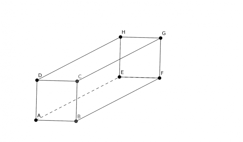

Given a rectangular parallelepiped ABCDEFGH, the diagonal [AG] crosses planes BDE and CFH in K and L. Show K and L are BDE's and CFH's centres of gravity.
I think I have understood the problem, could you verify my demo please ? Thanks
Let us call ##G_1## and ##G_2## BDE's and CFH's center of gravity.
## \vec{AG} = \vec{AB} + \vec{AD} + \vec{AE} = 3 \vec{AG_1}##
So ## A,G_1, G## are aligned and ##G_1## belongs to plane BDE so we must have ##K = G_1##
Then
## 3 \vec{AG_2} = \vec{AC} + \vec{AF} + \vec{AH} = \vec{AB} + \vec{BC} + \vec{AE}+\vec{EF} + \vec{AD} + \vec{DH} = \vec{AG} + \vec{BC} + \vec{EF}+\vec{DH} = 2\vec{AG}##
So, similarly, ## A,G_2, G## are aligned and ##G_2## belongs to plane CFH so we must have ##L = G_2##
Furthermore, ##K## and ##L## are at the third and two third of the diagonal.
It would help if you provided a picture of your regular parallelepiped with vertices labeled.
Hi, here is the picture
