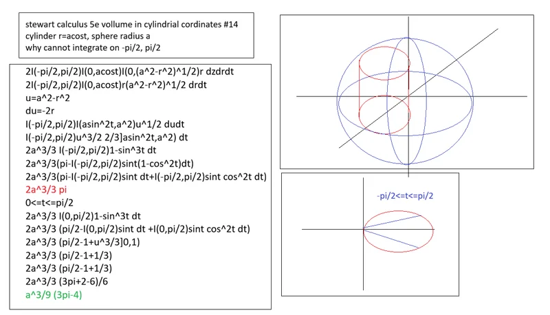

aronclark1017
31
TL;DR: I'm still debating on why exactly this is not compiling on -pi/2, pi/2. It has been suggested in other post that the square root of sin^2(t) on -pi/2 is to blame. However it looks to me that the polar equation can only exist at -pi/2 on second iteration causing some type of mysterious error.
Handwritten-style derivation of a cylindrical-coordinates volume integral over a sphere and cylinder, with a 3D diagram of a sphere and red cylinder above and an ellipse plot showing limits -pi/2 to pi/2 below.
How so? ##\sin^2(t) \ge 0## for all real numbers t. In particular, ##\sin^2(-\pi/2) = 1##.
In a more mathematical form that is easier to read, your first integral is:
$$2\int_{-\pi/2}^{\pi/2}\int_0^{a\cos(t)}\int_0^{a^2 - r^2}r~dzdrdt$$
Why do you have the constant 2 in front of the leftmost integral? The circle at the base of the cylinder is completely defined as t ranges from ##-\pi/2## to ##\pi/2##.
In addition, your work is extremely difficult to follow. It would be very helpful if you wrote your integrals and other mathematical stuff using LaTeX, similar to what I did above.
A few minutes studying our LaTeX Guide (the link is at the lower left) and applying what's there would probably cause more members to look at your posts.
Note that what I wrote is the following, in raw form:

Based on the sketch, it seems that ##\theta## is the angle of cylindrical polar coordinates, not spherical polar coordinates. I agree that the base of the cylinder is completely described by ##-\pi/2 \leq \theta \leq \pi/2##. The factor of 2 comes not from rotational symmetry about the origin (there isn't any) but from reflection in the plane ##z = 0##: we want the volume of intersection of the cylinder and the sphere, and that extends into negative ##z##.
The problem comes in line 6 of the OP's work which I interpret as $$\int_{-\pi/2}^{\pi/2} \left[ \tfrac23 u^{3/2}\right]_{a^2 \sin^2 \theta}^{a^2}\,d\theta = \frac{2a^3}3 \int_{-\pi/2}^{\pi/2} 1 - \sqrt[3/2]{\sin^2\theta}\,d\theta.$$ where we end up with an integrand involving ##\sqrt[3/2]{\sin^2\theta}##. This is not ##\sin^3 \theta##, as the OP has assumed, but ##|\sin^3 \theta|## since ##\sin\theta## is negative for ##-\pi/2 \leq \theta \leq 0##. I suspect this is where the OP has gone astray, although I'm not sure since their working is hard to follow. However, by evenness of ##\sin^2 \theta## we should now be at the point $$
\frac{4a^3}3 \int_0^{\pi/2} 1 - \sin^3 \theta\,d\theta.$$

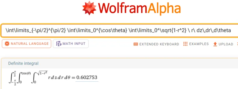

looks as if you want to integrate $$\int\limits_{-\pi/2}^{\pi/2}\ \int\limits_0^{a\cos\theta} \int\limits_0^\sqrt{a^2-r^2} \ r\ dz\,dr\,d\theta $$ Well, copy/paste the ##\LaTeX## code to Wolframalpha (with a=1 out of pure ignorance) and sure enough:
WolframAlpha input box containing the LaTeX-style triple integral from -pi/2 to pi/2, 0 to cos(theta), 0 to sqrt(1-r^2) of r dz dr dtheta, with the result 0.602753 shown beneath the typeset integral.
which is exactly one half of ##\frac 4 3 a^ 3\pi\left(\frac 1 2-\frac 2 {3\pi}\right ) ## or -- when typeset -- ##\frac 4 3 a^ 3\pi\left(\frac 1 2-\frac 2 {3\pi}\right ) ##
I'm impressed Wolfie expertly ignores the spacing I inserted for good measure...
Still curious about the tool you use ...
(where the graphics leave much to be desired ! Anyone who can suggest a freeware solids manipulation tool to visualize the intersection of a sphere and a cylinder ?)

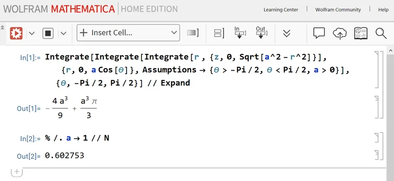

Just want to point out that the full version of Mathematica can evaluate the triple integral symbolically for arbitrary positive ##a\,##:
Screenshot of Wolfram Mathematica Home Edition showing input In[1] of a triple iterated integral in cylindrical-style limits with assumptions, output Out[1] = -4a^3/9 + a^3 pi/3, then In[2] substituting a = 1 with N giving Out[2] = 0.602753.
Any CAS which knows that for ##a \in \mathbb{R}##, ##(a^2)^{1/2} = |a|## should be able to get it right.
