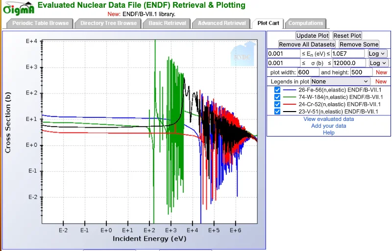

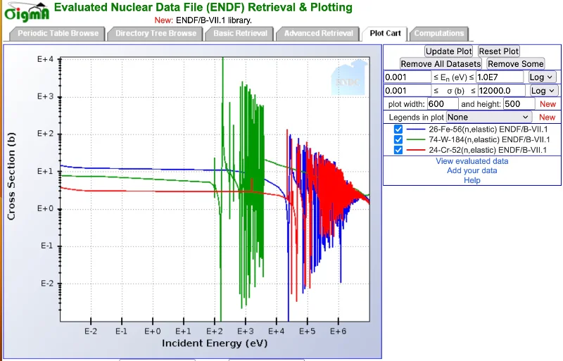

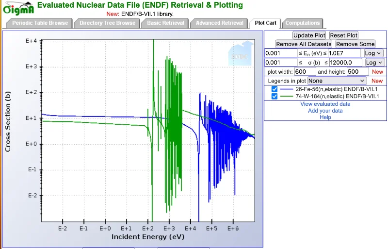

Please see attached figures which compare Fe-56 with W-184, then with Cr-52, and the third adding V-51. Vanadium is of interest since it has relatively low activation, and it fills a gap between Fe-56 and W-184.
Must also consider thermophyscial (density) and thermo-mechanical (e.g., strength), and corrosion resistance.

  • Plot of ENDF elastic neutron cross section in barns versus incident energy in eV, log-log axes, for Fe-56 (blue) and W-184 (green), showing resonance structure above about 1e2 eV.

  • Screenshot of the ENDF Retrieval & Plotting Plot Cart showing a log-log plot of elastic neutron cross section in barns against incident energy in eV, with three curves: Fe-56 in blue, W-184 in green and Cr-52 in red.

  • Plot of neutron elastic scattering cross section in barns against incident neutron energy in eV, log-log axes, for four ENDF/B-VII.1 isotopes: Fe-56, W-184, Cr-52 and V-51, from 1e-3 to 1e7 eV.
