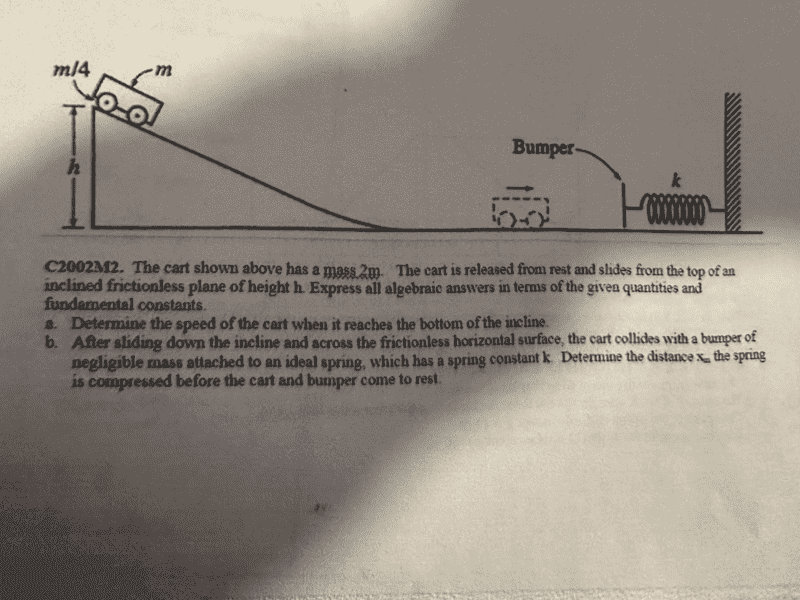

The cart is released from rest and slides from the top of an inclined frictionless plane of height h. Express all algebraic answers in terms of the given quantities and fundamental constants.
a) Determine the speed of the cart when it reaches the bottom of the incline.
b) After sliding down the incline and across the frictionless horizontal surface, the cart collides with a bumper of negligible mass attached to an ideal spring k. Determine the distance x_m the spring is compressed before the cart and bumper come to rest.
Conservation of energy
E_i = E_f
I'm using conservation of energy to solve for both a) and b).
a) Initially, the cart is released from rest, which has maximum GPE at the top of the inclined plane. U_g is converted to K.E as it reaches the bottom of the incline.
$$ E_i = E_f $$
$$ U_g = K.E_f$$
$$ 2mgh = \frac {1}{2}2mv^2$$
$$ v = \sqrt {2gh}$$
b) After sliding down the incline, the cart collides with the bumper, which transforms K.E in to spring P.E.
$$ E_i = E_f$$
$$\frac{1}{2}2mv^2 = \frac {1}{2}kx_m^2$$
$$ x_m = \sqrt \frac {2m}{k} v$$
where ##x_m## is the compressed spring distance.
In part a), I don't know how to find velocity in terms of mass because mass gets canceled out in the equation.

By the way, the diagram in the attachment shows the mass of the cart as m and there’s a curved arrow labelled m/4 to the left of the cart. The text of the question states the cart’s mass is 2m. So that’s very confusing!.
For your answer in part a) you have taken the mass as 2m. But in part b) you have taken the mass as m. So that’s inconsistent.
Each wheel is ##\frac{m}{4}##, that's how they imply the mass is ##2m##.

Since the masses of the wheels are given, I guess you are expected to take into account rotational KE of the wheels. More guessing: the wheels can be modeled as uniform solid disks and they roll without slipping.
I think it says it is a frictionless track though. I think they are just trying to be sneaky by providing the mass of the wheel.
Yes. You’re right. I missed “ frictionless”. I also missed “sliding” in part (b). :blushing:

paulimerci said:
Are the expressions correct? I understood that my answer doesn’t depend on masses falling down or on a frictionless incline.
Your answers and work in post #1 look correct.
When a problem says to write the answer in terms of certain given variables, it only means you can’t use any others. There is no requirement to use all of them if some are redundant.
But btw, your answer to part b violates the instruction by using v in the answer. And, technically, I don't think g counts as a "fundamental constant", but there's nothing you can do about that.

No, it does depend on its being frictionless, or you would have to account for the rotational KE of the wheels. That would reduce v but not affect the spring compression.
