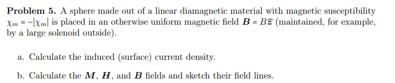

a) Find the induced surface current density
b) Find the M, B and H-fields
See solution.
Problem:
Typeset textbook problem 5: a diamagnetic sphere with susceptibility χm = -|χm| placed in a uniform field B = Bẑ; parts a) calculate surface current density, b) calculate the M, H and B fields and sketch their field lines.

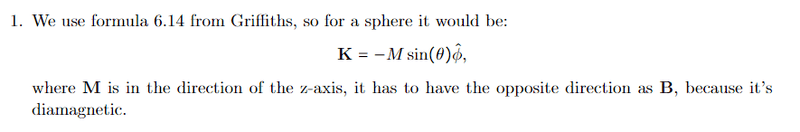

Solution part a)
Typed solution text: We use formula 6.14 from Griffiths, so for a sphere it would be K = -M sin(theta) phi-hat, where M is in the direction of the z-axis, opposite to B, because it's diamagnetic.
where formula 6.14 is just M x n.
We need to do part b without separation of variables, I'm quite stuck. Will B just be the magnetic field inside a solenoid? How can I find the other fields.

One additional input: You really need to compute the resulting magnetization ## M ## before you can do part "a" which is to compute the magnetic surface current density.

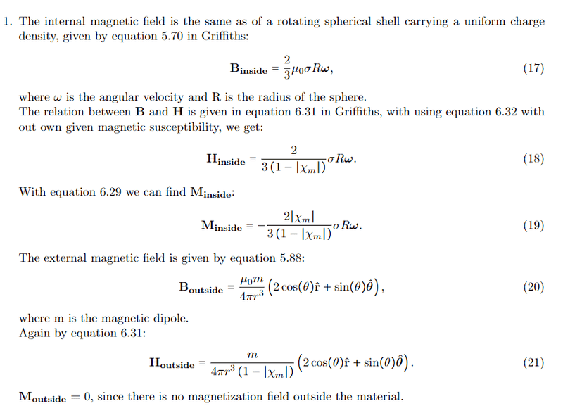

Luckily we were allowed to use already calculated expressions for the internal- and external magnetic fields. This is what I got:
Typeset derivation of magnetic fields for a rotating charged sphere: inside B and H and M expressions in equations 17 to 19, outside B and H dipole expressions in equations 20 and 21, and M outside equals zero.
(The angular velocity is supposed to be bold, but I have dificulty bolding greek symbols. And "with our own given magnetic susceptibility" instead of out.).
I don't agree completely with your answer. Since this is really not an Introductory Physics problem, let me show you what I got for ## B_{inside} ## and ## H_{inside} ##, etc. The first part I don't agree with that ## B_{inside}=(2/3) M ## using units where ## B=\mu_o H+M ## and ## M=\mu_o \chi H=-\mu_o |\chi| H ##, because ## H_i=H_a-M/(3 \mu_o) ##, so the ## H_a ## complicates matters somewhat.
Let me show you how the ## H_i ## is obtained from ## H_a ##, where you really need a ## B_a ## with a subscript for the applied ## B ##, where ## B_a=\mu_o H_a ##.
## E_i=E_a-P/(3 \epsilon_o) ## using the demagnetizing factor ## D=1/3 ## for a sphere.
Now ##P= P_i=\epsilon_o \chi E_i ## so ## E_i=E_a/(1+\frac{\chi}{3}) ##, so that ## H_i=H_a/(1-\frac{|\chi|}{3}) ##, and ## M=-\mu_o |\chi| H_i=-|\chi|B_a/(1-\frac{|\chi|}{3}) ##, and ## B_i=\mu_o(1+\chi )H_i=B_a(1-|\chi|)/(1-\frac{|\chi|}{3}) ##.
Note: ## M=\mu_o \sigma R \omega ##, but not every formula works for that solution, because of the ## B_a ##.
Once we get agreement with the inside, then we'll take a closer look at the outside. Please let me know if you were able to follow the calculations.

Yes I was able to follow the calculations.
Would B_outside be $$-\frac{M_0 R^3}{3 \mu_0 r^2} \left( \cos(\theta) \mathbf{\hat{r}} + \frac{\sin(\theta)}{r}\mathbf{\hat{\theta}} \right)$$?

True, also forgot to take the negative when doing the gradient it should be this ##\frac{M_0 R^3}{3 \mu_0 r^3} \left( 2\cos(\theta) \mathbf{\hat{r} + \sin(\theta)}\mathbf{\hat{\theta}} \right)##. So we have ##B_i = B_a - \frac{M}{3 \mu_0} ##
Looks good for ## B_{outside} ##, but add ## B_a=B_o \hat{z} ##.
For ## B_i ##, what I have in post 8 is complete. (You don't need to add any ## B_a ## to that). The expression ## B_i=B_a-M/(3 \mu_o) ## is not correct though=we have ## H_i =H_a-M/(3 \mu_o) ##, but ## B_i=\mu_o H+M=\mu_o H_a-M/3+M=B_a+(2/3)M ##.
