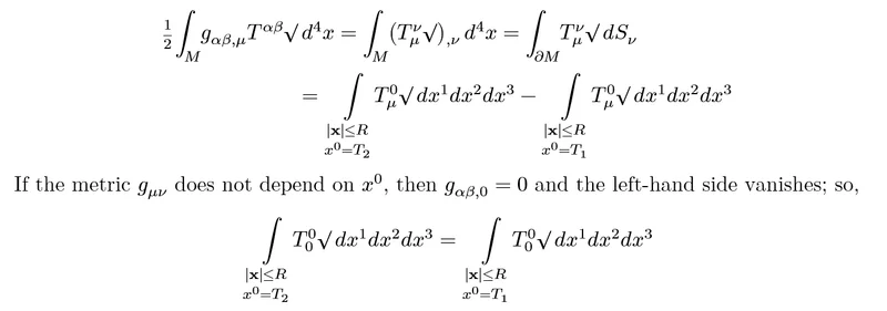

Below is a derivation of a global (not local!) energy conservation law that holds in general relativity... almost! It holds for ##T^0_{\,0}##, but I want ##T^{00}##.....
Please see the derivation below that, if the metric is time-independent, then the integral over a sufficiently large 4D spacetime region of ##T^0_{\,0} \sqrt{-g}## is independent of time, where ##T^{\mu\nu}## is the energy-momentum tensor of a relevant collection of matter-energy fields. Thus, I am tempted to conclude that there is a global conservation law for energy in general relativity.
(Of course, there is no local conservation law for energy, since the energy of the matter-energy fields is being exchanged with the energy of the gravitational field ... this issue is well known, and follows from the equivalence principle.)

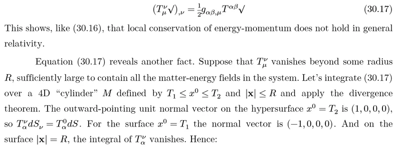

The sticky problem is that ##T^{00} \sqrt{-g}## is the energy density in general relativity, not ##T^0_{\,0} \sqrt{-g}##. If I write $$T^0_{\,0}=g_{\lambda 0}T^{\lambda 0}$$ then I don't really get what I want -- I do not isolate ##T^{00}##. Is there a way to save this proof?
Note, the first equation (30.17) shown below is from Dirac's "General Theory of Relativity", eq. (21.4), and is a standard divergence-theorem result.
Equation (30.17): the covariant divergence of T^nu_mu sqrt(-g) equals one half g_{alpha beta, mu} T^{alpha beta} sqrt(-g), followed by surrounding printed text discussing local energy-momentum conservation and the divergence theorem.
Text reading: In other words, a time-independent metric implies global conservation of energy. So, while the concept of local energy density of the gravitational field does not exist, global energy conservation still holds.
You should resist the temptation. All you have done is rediscover the Komar energy. Which is a perfectly good integral conserved quantity in a stationary spacetime--but only in a stationary spacetime. That's an extremely restrictive condition, and certainly is not the same as finding a global conservation of energy law for "general relativity" as a whole.

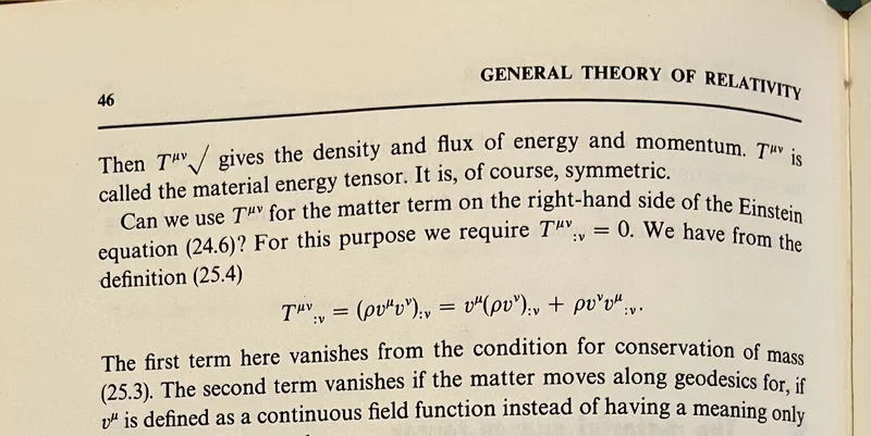

I don't think that is right. Dirac gives a very clear explanation why ##T^{\mu\nu}\sqrt{-g}## is the density of energy-momentum in curved spacetime.

What I said in my last post is what you'll find in many GR textbooks: MTW and Wald, for example, to name just the two best known classics in the field.
What you showed from Dirac gives no argument for the claim you're citing.
As I said, he gives a very clear explanation.

Pp. 45-46 explain the energy-momentum tensor for a dust and his comment that ##T^{\mu\nu}\sqrt{-g}## is the density and flux of energy and momentum. Schutz’s text does the same in more detail.
I am more interested in the question raised in #3 above. How does Dirac justify treating the mixed tensor density ##T^{0}_{\,0}\sqrt{-g}## as the energy density ##T^{00}\sqrt{-g}##?
