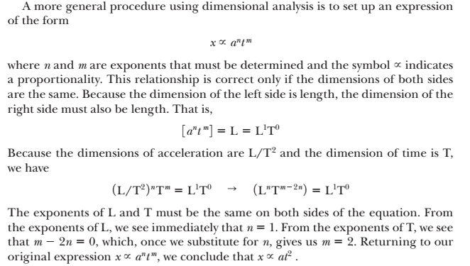

This is actually an example from Physics for Scientists and Engineers by Serway. I am confused about the way they solved it.
Suppose we are told that acceleration a of a particle moving with uniform speed v in a circle of radius r is proportional to some power of r, say r^m, and some power of v, say v^m. Determine the values of n and m and write the simplest form of an equation for the acceleration.
The problem is solved in the book. But I don't understand the solution properly.This problem was solved in the example as below:
[tex]a = k(r^n)(v^m)[/tex][tex]L/T^2 = (L^n)(L/T)^m = L^{n+m}/T^m[/tex][tex]n+m = 1[/tex][tex]m = 2[/tex][tex]n = -1[/tex][tex]a = kr^{-1}v^2[/tex]
From the question we don't know if k has any dimension or not. So how did they (in the second line) write [tex]L/T^2=(L^n)(L/T)^m ?[/tex] Where did the k go??

It never seems to be the case. Serway's book describes it as a general procedure. Here is the excerpt from Serway's book:(as this page can be previewed in amazon; I think it never breaks any copyright)
Now this certainly works for x ∞ (a^n)(t^m); but what happens when we apply this for, say - the law of gravitation? Here, F ∞ Mm/r^2 certainly doesn't pass the test of dimensional analysis (?). I am confused!
Well, why don't you apply dimensional analysis to the law of gravitation? Hint: not every constant of proportionality is unitless, like the π in A = π r[itex]^{2}[/itex] for the area of a circle. And besides, 'constant' means the value doesn't change; it doesn't mean there are no units.

Thanks.
So I conclude - dimensional analysis works for equations; but it will work for proportionality only if the constant is unit less. (The book was a bit confusing.)
