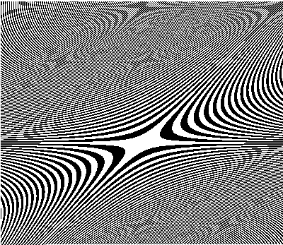

About your patterns. They have nothing to do with prime numbers, fractals or complex numbers. The reason you see a pattern with repeating characterestics and "hard" edges where the brightness flips from maximum to zero is that you are reducing the values you are calculating modulo 255.
Whilst these patterns can be pretty, I don't think there is any underlying significance that makes them worth investigating from a mathematical point of view. By all means continue your investigations, but you should also spend some time looking at the interesting patterns and other features about primes that other people have found.
I think you can collect your £20. I don't think this has anything to do with the Mandelbrot set at all.
The lines where you have a sudden change from red to black in your image are, the places where y(y+x) % 255 rolls over from 255 to 0, so this happens when y(y+x) = 256 k, where k is ..., -2, -1, 0, 1, 2, ,,,,,,,,
You can only see these curved lines around (0,0) however. They are clearer in this version, where I put the lines further apart
If you had an infinite resolution screen, the entire picture would be filled with a line pattern as in the center.
The farther away from 0,0 you get, the closer the lines get however, until you can't see the lines at all anymore, but only new patterns created by the jagged lines and the low resolution of the image.
This is what is know as a Moire pattern. http://mathworld.wolfram.com/MoirePattern.html
You can often see those if you look through 2 fences behind each other, but you can also get them when displaying a series of curves on the rectangular grid of a computer monitor.
(note the 3 disk images on the wolfram page, where a series of circles interacts with the rectangular pixel grid)
Your prime search program seems to be a version of trial division.
You form the set of numbers y(y+x) with x>1 and y>1, but this is the same set of numbers as
yx with x>1, y>1 and y>x.

I am aware of this.
I am aware of this.I understand that the "zooming out"- is a side effect to the interesting patterns created.
Although, if I understand correctly, when you refer to the lines- I believe you talk about something I call "the greater boxes"-built out of the "greater triangles" and the "greater meeting circles".
It appears to me that, if you can find a way of simplifying the larger numbers down into a smaller one that resides into the one box at the point of origin.
Then, if the number resides within that box, it is non-prime.
The problem, of course "is the modulus 255".
Modulus 255
Interestingly I have managed to work around this problem- using a special function I have found a way of representing all of the 255*255*255 colours.
This means that I can zoom in incredibly- each zoom providing more fantastic imagery.
Obviously I have not got this system completely working- but this is the code I have as of now:
