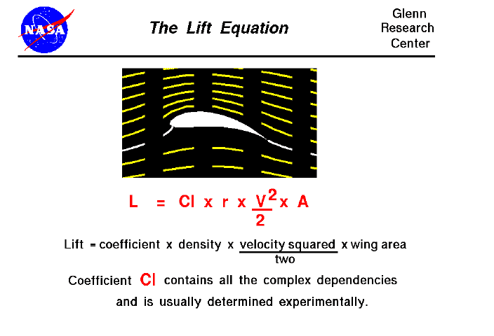

Lift Equation gives me 12.25 Newtons per wing. Am I using it right?
Saw this equation on Nasa's website about lift equation:
I'm trying to build a miniature helicopter and decided to test that equation.
For CI I used 0.5 because I saw a graph where flat air foils gets 0.5 CI when placed at around 10 degrees.
For air density I went with 1.225 because I live near sea levels.
For Velocity I used 20m/s and for A I used 0.1 m^2.
0.5 * 1.225 * (20^2)/2 * 0.1 = 12.25 N (I'm guessing the output is in newtons)
If multiplied by 4 wings, it gives 49N. Divided by gravity, around 5Kg.
Am I doing this right? Does that mean 3 0.1m^2 wings can lift around 5Kg?

I'm not going to be of much help except to ask for clarification on the velocity number. A propeller is not a wing. The air velocity varies with radius, and the angle of the "wing" for a propeller usually varies with radius because of this. Are you taking this into account?

I converted the RPM's of my motor to m/s using 0.1 as the radius. I did not understand the angle part

https://www.grc.nasa.gov/www/k-12/VirtualAero/BottleRocket/airplane/lifteq.html

Three blades of ##0.1 m^2## will make the span of the rotor to be around 2 meters, which will require a very powerful engine to make the tips of the blades to spin at ##20 m/s## (at 190 rpm).
All the weight is going to be hanging from the blades, reason for which their cross section must be robust and thick, which makes your flat blade a poor choice.
That tangential velocity (and associate lift) will decrease to close to zero as you move towards the root of the blade.
Consider that the NASA simulator is for a wing of infinite span, which does not suffer the tip vortices of a real wing that decrease the lift.
Also, the maximum lift is achieved around 10° of angle of attack.
The wing or blade will stall and loose most of the lift if that angle increases.
Therefore, the root of your blade can have that maximum angle, but it must decrease as moving towards the tip, reason for which your blade should have a twisted profile.
Because of that, you will not be able to have the values of max velocity and max angle of attack and max CL that you have input into your equation for all the sections of your blade.
Root of the blade: Lift is associate to slowest tangential velocity and maximum CL or AOA.
Tip of the blade: Lift is associate to fastest tangential velocity and small CL or AOA.

You don't need to guess the units of the answer, you need to work with units.
##F = CI \rho \frac{v^2}{2} A = 0.5 \frac{1.225 kg}{m^3} \frac{(20 m/s)^2}{2} 0.1 m^2 = 12.25 kg \frac{m}{s^2} = 12.25 N##
This formula is assuming all of the wing has the same velocity relative to the air. Your helicopter blades won't. Most of the lift will come from the area near the end, while the slower parts in the center will provide less lift. The formula also assumes a single wing that goes through undisturbed air, which isn't necessarily the case for your helicopter.
You cannot have an area of 0.1 m^2 with a radius of 0.1 m.
