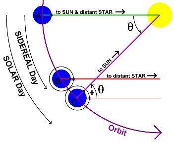

Sorry for the basic question about the planet as the Earth (surely it is not a level I question 🤔 )
As in the picture, start with the sun at noon at the reference meridian. From the beginning of the second sidereal day the Earth must rotate further around its axis to sweep an angle of about 1 degree (0.9856 degree) in order to re-align the reference meridian with the sun (this basically amounts to 3m 56s as the difference in duration between a solar day and a sidereal day).
What about the second solar day ? This time -- starting from the beginning of the third sidereal day -- the angle the Earth's rotation has to sweep is actually the double of the previous one (2x0.9856 = 1,9712 degree).
If the above is correct, does the difference between solar vs sidereal day remain constant over the year (3m 56s) ?

Your statement for the first day is correct.
The second day is the same as the first. You start from solar noon, not from the beginning of the sidereal day, so it takes an addition 3m 56s to come back to solar noon. If you start from the same sidereal time each day, it is true that the difference between solar time and sidereal time accumulates as you move through the year. On the autumnal equinox, the difference is zero, and six months later on the vernal equinox, the difference is 12 hours.
The difference between the solar day and the sidereal day is not exactly the same through the year. The time for the Earth to rotate on its axis stays the same through the year to high accuracy. But the rate of motion of the Earth around the orbit changes because sometimes the Earth is slightly closer to the sun than others. When it is closer to the sun, it moves faster. The difference through the year is summarized as the Equation of Time. The 3m 56s is the average difference through the year.

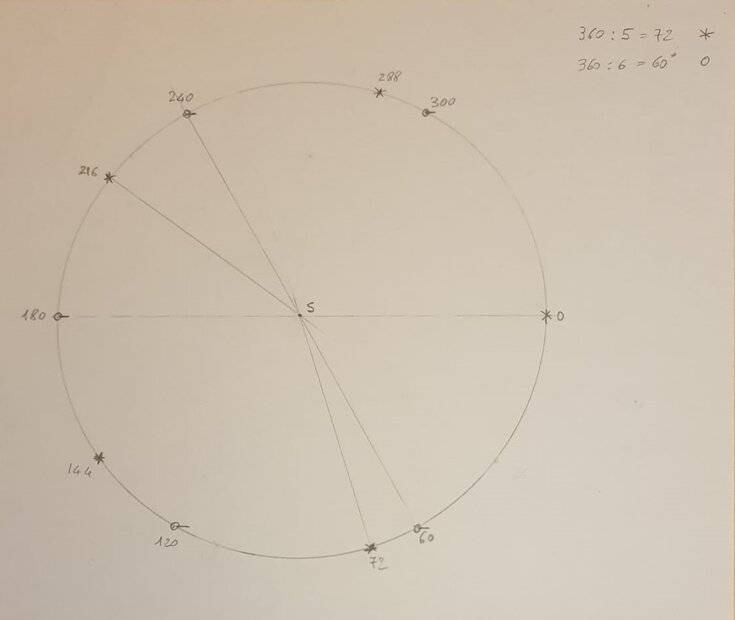

Just to be sure about my understanding, I made this example:
In this picture '*' are the solar noons and 'o' are the "fixed star" noons (i.e. the end/start of a solar day vs the end/start of a sidereal day respectively). As you can see in one sidereal year there are 6 sidereal days and 5 solar days.
Is that correct ? Thank you.
phyzguy said:
The observer (you) is the small red stick figure.
Thank you, it is really appreciated. I take it as in the animated square on the right (the observer's visible celestial semisphere), the center is the observer's zenith and the apparent motion of the sun and stars occours orthogonal to the observer's upper celestial meridiane (i.e. the part of celestial meridian above the observer's horizon).
Yes, exactly.

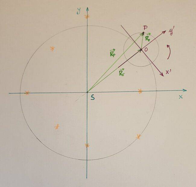

To help my understanding I made this diagram
The are basically two reference frames involved: the first one (S,x,y) having the center in the sun (S) in which distant stars are at rest and the second one (O,x',y') co-moving with the Earth-Sun line during the sidereal year.
##\vec R_P (t)## is the position vector of the point P (a given point P on the Earth surface) in the (S,x,y) frame, ##\vec R_E (t)## is the position vector of the Earth's center in the same (S,x,y) frame and ##\vec R_T (t)## is the point P position vector in the (O,x',y') frame.
Now ##\vec R_T (t) = \vec R_P (t) - \vec R_E (t)## and in the (O,x',y') frame the point P rotates around the origin O with angular velocity ##\omega_{sol}##.
As we said, the motion of P in the (S,x,y) frame is complicated due to the revolution of the Earth around the sun, so I believe in the (S,x,y) frame we cannot actually claim the point P just rotates with a given angular velocity - since after a turn of the Earth around itself the point P does not return on the same point in the (S,x,y) frame.
So basically what you are saying is that if we did the exact calculation -- i.e. the derivative of ##\vec R_T (t)## in the (O,x',y') frame -- we would find that the angular velocity ##\omega_{sol}## of the point P in the (O,x',y') frame should be exactly equal to:
$$\omega_{sol} = \omega_{sid} - \omega_{E}$$
##\omega_E## is the angular velocity of the center of the Earth (point O) in the (S,x,y) frame.
Does it make sense ? Thank you.

Any feedback about my post #24 ? Thank you.
To be honest I didn't fully grasp everything you are saying, but I think what you are saying is correct. It feels like you are over-thinking this. It seems to me like a simple argument. If you start with the sun and some star on the meridian, after 23h 56m the star will have returned to the meridian, but it takes an additional 4 minutes (actually 3m 56s) for the sun to return to the meridian because of the Earth's motion around the sun. That's all there is to it, and there are probably many ways to state it. When you start worrying about the different frames, it can get very complicated. The sun is orbiting around the galactic center, and the galaxy has its own motion. Also, the Earth doesn't simply orbit the sun, they actually orbit around the solar system barycenter in a complex dance.

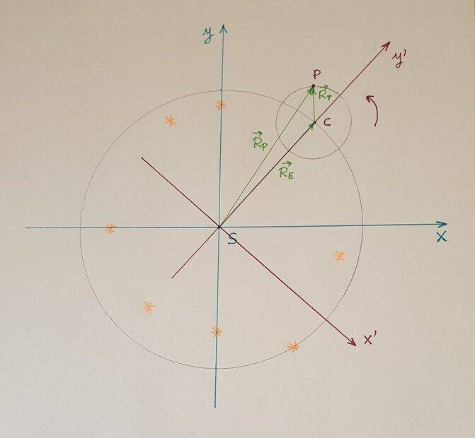

By the way, it is worth to mention that in post #24 the co-moving frame (O,x',y') is not jointed with the Earth as rigid body. In fact in that frame a point P (say a point on a Earth's equator) is actually moving around the origin O with an angular velocity ##\omega_{sol}##.
It should be the same as choosing as (x',y') frame the red frame depicted in the following diagram having the origin in the Sun.
