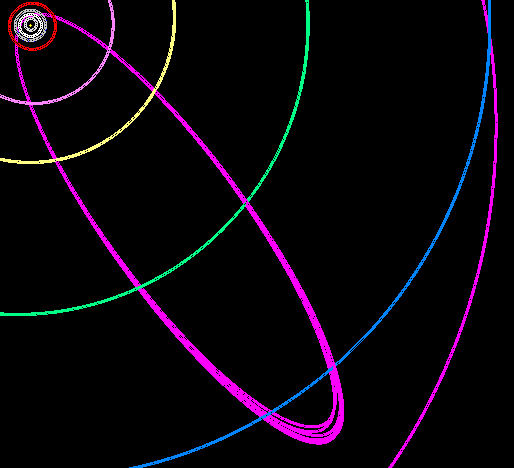

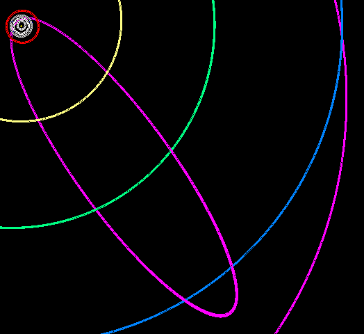

Here are the results of 2 simulations of Haley's comet. In the first simulation the masses of all the planets and Pluto are included. In the second simulation Jupiter is deleted. Both simulations run for 455 years, from 2007 to 2462.
It's obvious from these images that Jupiter is by far the largest perturber of Haley's orbit. The changes in Haley's semi-major axis, which can be seen by looking at its aphelion (furthest point from the Sun) will have an effect on its orbital period. I would guess that 500 days is reasonable.
