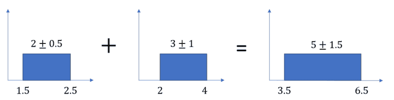

Let's say we are adding two numbers. The result is simple.
$$2+3=5$$

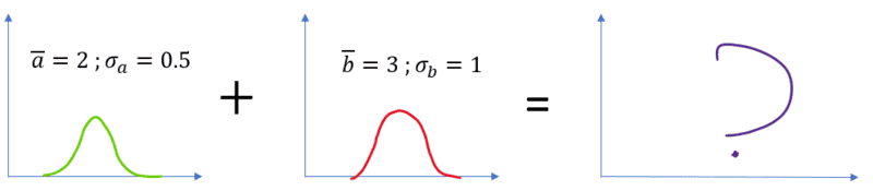

However, let's now think of a scenario where 2 and 3 are not set. Instead, they follow a probability distribution. To start with something simple, let's assume they are constant distributions as shown.
In this case, I believe that's right so I know how to do it.
$$(2\pm 0.5)+(3\pm 1)=5\pm 1.5$$
But if the probability distributions get more complex I do not know how I could try to solve it. For example:
I used a normal distribution but I am certain there must be a generalized way to calculate it for any given probability distribution. I am interested in being able to answer the following:

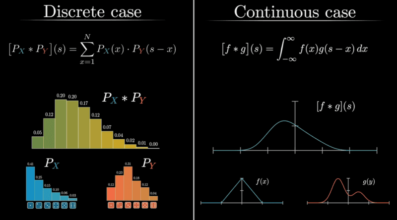

I kept checking the matter on the internet and thankfully I found a video that covered the point in detail. It is from the wonderful channel 3Blue1Brown and it is about convolution.
It actually bothers me a little that I watched this video when it was published but I didn't really understand it that well back then. Now that I needed it my brain didn't add 2+2 together to take me back to the video so I had to rediscover it. At least, the video is so good that rediscovering it doesn't feel bad at all.
First of all, I want to point out an error I committed in the original post.
$$2+3=5$$

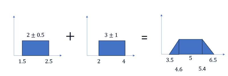

The result I posted is not the correct probability density function. The whole spectrum of possibilities is indeed right. The result will vary between ##3.5## and ##6.5##. However, the probabilities assigned in the drawing are not correct.
To find the correct probability distribution it is necessary to apply the convolution to the two original probability density functions.
NOTE: The functions for the dice are weird because he's talking about weighted dice in that case.
I initially proposed those constant probability functions because they seemed like the simplest possible option but it turns out that, since the functions are defined in segments and there is no variable in those segments, the convolution formula isn't as straightforward.

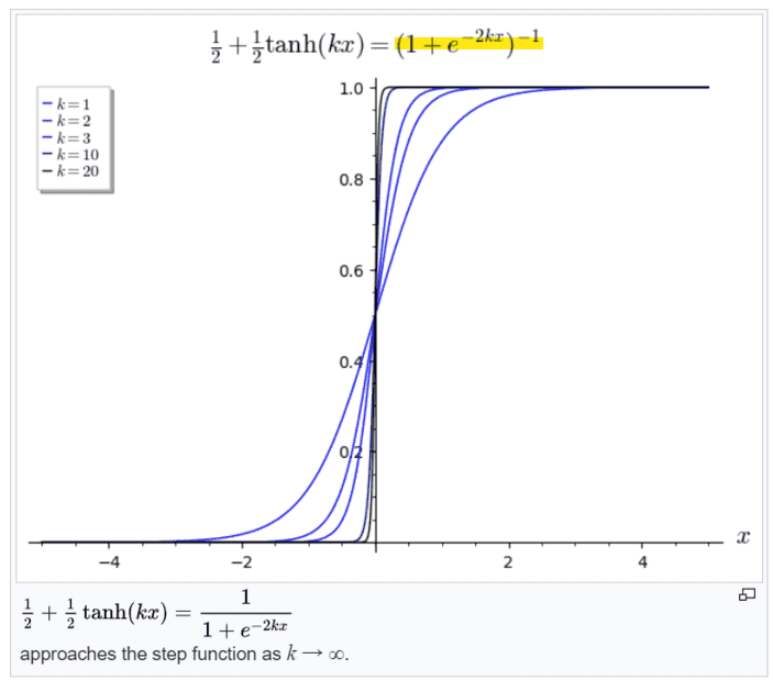

I generalized it using two step functions so the probability distributions are defined by just one function in all ##\mathbb{R}##.
Once that's done, it is easy to apply the formulas as long as it is a computer crunching the numbers.

The way to handle this is a little harder than your first idea of just adding the ##\pm## numbers but is much simpler than your latest post. You do not need to know the entire probability distribution and compute convolutions.
When you say that one variable, X, is ##2 \pm 0.5##, you are saying that you have some level of confidence that the value will be within ##\pm 0.5## of ##2##. Assume that you are using the same level of confidence for the second variable, Y, and can say with that confidence that it is within ##\pm 1## of ##3##. Also assume that the variation of the two variables, X and Y, are independent of each other.
Suppose that you want to keep the same level of confidence for the sum, X+Y, being within some distance of the mean of X+Y. The trick is that to find the deviation of the sum, you must add the squares of the individual deviations and then take the square root. So you should calculate ##\sqrt {0.5^2 + 1^2} = \sqrt {1.25} = 1.118##. The final answer is ##5 \pm 1.118## with the same confidence of the original two variables.
EDIT, ADDED JUSTIFICATION: Let ##\mu_X## and ##\mu_Y## denote the means of the variables and ##\sigma_X, \sigma_Y## their standard deviations. Saying that you want the same level of confidence that the variables, X, Y, and X+Y to be within a certain distance of their means is to say that you want the ##\pm## numbers to be the same multiple, a, of their respective standard deviations. That is, you want ##a\cdot\sigma_X, a\cdot\sigma_Y, a\cdot\sigma_{X+Y}## to be 0.5, 1, and [to be determined].
The equation for ##a\cdot\sigma_{X+Y}## is ##a \sqrt{ \sigma_X^2 + \sigma_Y^2} = \sqrt{(a\cdot\sigma_X)^2 + (a\cdot\sigma_Y)^2} = \sqrt {0.5^2 + 1^2} = \sqrt {1.25} = 1.118##

If I try to apply your logic to this constant distribution I get strange results. In that example, I assumed a constant pdf so I have 100% confidence the number will be within those margins.
Following the logic you exposed, does that mean that I can be 100% confident that the sum will be ##5 \pm 1.118##? That makes no sense to me.
I cannot draw the exact resultant pdf from the convolution yet. But looking at how the value that the resultant pdf would take changes as I use the slider that defines ##s## I can see it'd look like a trapezoid.
By the way, that result coincides with the intuition you mentioned in your second edit. It's less likely to obtain a very small sum because it'd require both inputs to be very small. The same applies to a big sum. It's the numbers in the middle that will be more likely because they can be produced by:

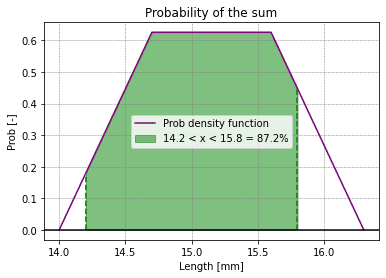

Thanks to the arrival of ChatGPT the barrier for coding is now much lower than it used to be. I could write some basic code reasonably quickly to find the convolution of two constant probability density functions.
Being this the input:
#Nominal values of each measurement.
L_1_nom = 5 #[mm]
L_2_nom = 10 #[mm]
#Tolerance bracket of each measurement.
tol_sup_1 = .5 #[mm]
tol_inf_1 = -.2 #[mm]
tol_sup_2 = .8 #[mm]
tol_inf_2 = -.8 #[mm]
# Limiting values.
lim_inf = 14.2
lim_sup = 15.8
Here is the output:
This is still far from done. To be useful in any way I need to keep crunching numbers so that I can make an informed decision regarding the tolerance bracket so that it allows me to keep the sum within certain values with a x% certainty. Maximizing the tolerance bracket should make the parts easier and cheaper to manufacture.
At least, with this code, I can now do the brute force approach where I keep changing the input parameters until the output looks acceptable.

# It's now possible to find the probability of the sum being between two values.
lim_inf = 14.2
lim_sup = 15.8
Prob_result = calcular_area(Conv_sol[0], Conv_sol[1], lim_inf, lim_sup)
print('Probability of the sum being between', lim_inf, 'mm and', lim_sup, 'mm is', np.round(Prob_result*100, 2), '%.')
def plot_function_with_area(x, y, x_val1, x_val2, title, f_label, x_label, y_label, prob_value):
Draws the function defined by the vectors x and y, and fills the area between x_val1 and x_val2.
:param x: Vector of x coordinates
:param y: Vector of values corresponding to x
:param x_val1: First value of x where a vertical line is drawn
:param x_val2: Second value of x where a vertical line is drawn
# Find the closest positions to the input values.
idx1 = np.argmin(np.abs(x - x_val1))
idx2 = np.argmin(np.abs(x - x_val2))
# Make sure idx1 is lower than idx2
if idx1 > idx2:
idx1, idx2 = idx2, idx1
plt.plot(x, y, label=f_label, color='purple')
plt.vlines(x=x[idx1], ymin=0, ymax=y[idx1], color='green', linestyle='--')
plt.vlines(x=x[idx2], ymin=0, ymax=y[idx2], color='green', linestyle='--')
plt.xlabel(x_label)
plt.ylabel(y_label)
plt.title(title)
plt.axhline(y=0, color='black', linestyle='-')
plt.grid(True, which='both', linestyle='--', linewidth=0.5, color='gray')
label=f'{x_val1} < x < {x_val2} = {round(prob_value*100,2)}%'
plt.fill_between(x[idx1:idx2+1], y[idx1:idx2+1], color='green', alpha=0.5, label=label)
plt.legend()
plt.show()
plot_function_with_area(Conv_sol[0], Conv_sol[1], lim_inf, lim_sup, 'Probability of the sum', 'Prob density function', 'Length [mm]', 'Prob [-]', Prob_result)[/CODE]
