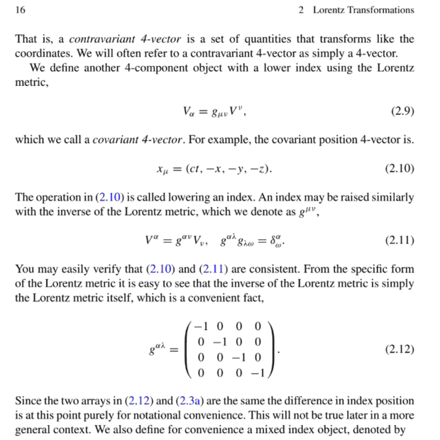

I bought a copy of Adler's new book on relativity. Is there a misprint on page 16 regarding the Lorentz metric = diag (-1,-1,-1,-1) or am I missing something? The text itself after the equation suggests it is the same metric as on the earlier page so that index placement, two lower indices vs two upper indices is irrelevant to the form of the matrix?

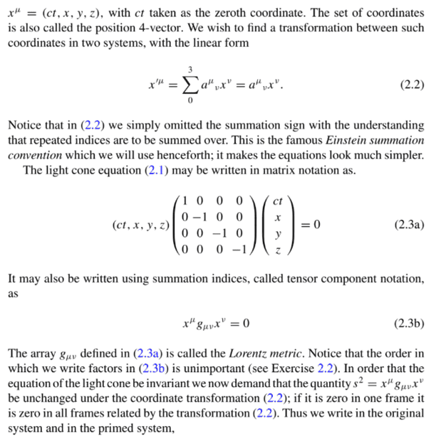

Did you mean the Minkowski metric, usually written ##\eta_{ab}##, which is either ##\mathrm{diag}(+1,-1,-1,-1)## or ##\mathrm{diag}(-1,+1,+1,+1)##? Then what you've written is misprint, unless he's got into raising and lowering indices and is noting that ##\eta^a{}_b=\mathrm{diag}(1,1,1,1)##.

Here is the page from Google Books
and here is the "earlier" page
Thanks, Malawi_Glenn. It certainly looks like a misprint.

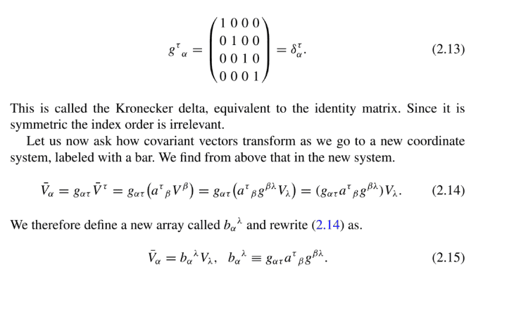

Then yes, it's a misprint (my point about ##\eta^a{}_b## is 2.13, although he uses ##g##).
