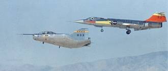

One example that somewhat disproves this is the unusually shaped M2-F2 and M2-F3 lifting bodies used as re-rentry prototypes. Part of the reason for the unusual shape is that as re-rentry vehicles, they need to operate at hyper-sonic speeds (or at least survive such speeds), but they also glide reasonably well.
wiki articles:
http://en.wikipedia.org/wiki/Northrop_M2-F2
http://en.wikipedia.org/wiki/Northrop_M2-F3
m2-f2 (and F104) on landing approach:
Photo of two aircraft in flight over mountainous terrain: a lifting body with a rounded grey nose and a number 803 on its side in the foreground, and a Lockheed F-104 Starfighter with a blue and white paint scheme and red-tipped tail below and behind it.
