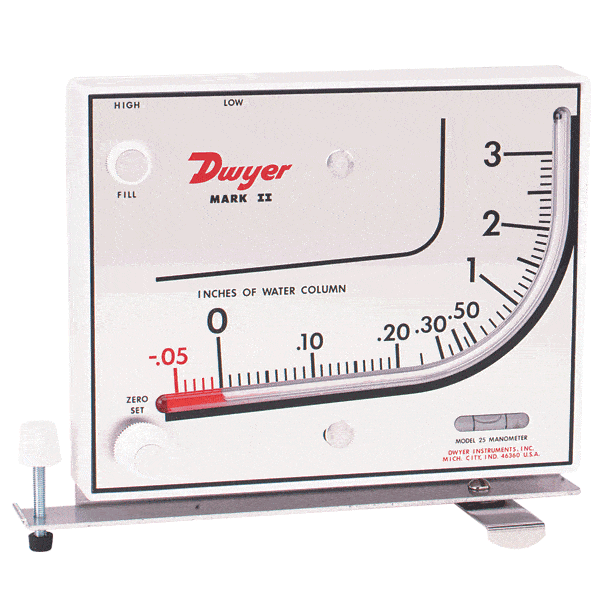

First of all I'd like to apologise for my question, as it will probably be embarrassingly easy to answer but I don't have any idea.
I've recently been given the role of running a manufacturing centre for F1 in Schools and everything is going well apart from one area.
We have a wind tunnel to check the aerodynamics of small F1 cars made from balsa wood. The wind tunnel comes with a manometer which apparently gives an accurate reading for wind speed and also a display showing the amount of drag in grams.
Could someone please explain what this means and how I can use the figures?
Regards Dean
Basically the instrument will allow you to measure the aerodynamic drag in grams on the F1 car for the selected wind speed. Different cars will have differing amounts of drag at the same speed.
The car is mounted on or against the test stand and the wind speed adjusted to the desired speed. The manometer allows you to match speeds from test to test or at least measure and compensate for the difference. The drag in grams indicates how much force is needed to overcome the drag.
Does your manometer look something like this?
Your manometer problem then is to convert from whatever are the units on your manometer to miles-per-hour or feet-per-second or something ?
Doh! I translated manometer to anemometer.
Edit: Although the manometer may be scaled for windspeed at STP.

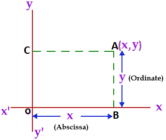

Basics of a graph:
It shows the interrelationship between two things that you measure , those two things are called your "variables"
To make a graph one establishes two scales one horizontal and one vertical
like this
Horizontal scale is named the "abscissa"
vertical scale is named "ordinate"
but hardly anyone calls them that
we say horizontal and vertical because that's more mnemonic, or often X for horizontal and Y for vertical.
and where they intersect is called "origin" or sometimes "zero, zero"
To gather data for his graph
one controls one of his variables , observes and writes down how the other behaves.
He gets a series of paired values for his two variables.
For each pair of values he puts a dot on his graph.
it is traditional to use horizontal for the controlled variable
and vertical for the observed variable
so one chooses scales for horizontal and vertical that encompass all his numbers

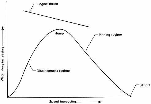

On the numberless graph here
horizontal is controlled variable, speed
vertical is observed variable drag
probably for a seaplane taking off from water -
you can see drag first increase with speed than decrease as the hull transitions from displacement to planing .
(Ever water ski? If so you've felt that transition...)
and as hull leaves the water there's no more water drag .So you'll measure drag at increasing speed and graph the results
kid with lowest drag curve wins.
