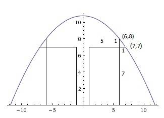

This is another question about parabola?
This is another question about parabola.
A tunnel is to built to allow 2 lanes of traffic to pass from one side of a mountain to the other side. The largest vehicles are trucks, which can be considered as rectangles 5m wide and 7m high.
Investigate the cross-section of a parabolic tunnel and find a possible equation to represent it. Allow some space so trucks do not bump into each other or the sides of the tunnel.

Hello ale,
Let's orient the origin of our coordinate system such that it is at the mid-point of the base of the cross-section, with the vertex of the parabola directly above it.
Let's allow 1 m on either side of the trucks and above them as in the diagram:
https://www.physicsforums.com/attachments/832._xfImport
We see we will require the parabola to pass through the points:
$$(\pm6,8),\,(\pm7,7)$$
Now, letting the parabola be:
$$P(x)=ax^2+bx+c$$
we obtain the linear system:
(1) $$P(6)=36a+6b+c=8$$
(2) $$P(-6)=36a-6b+c=8$$
(3) $$P(7)=49a+7b+c=7$$
(4) $$P(-7)=49a-7b+c=7$$
Adding (1) and (2) and (3) and (4) to eliminate $b$, we get:
(5) $$36a+c=8$$
(6) $$49a+c=7$$
Subtracting the (5) from (6) to eliminate $c$, we find:
$$13a=-1\,\therefore\,a=-\frac{1}{13}$$
and so substituting into (5), we have:
$$36\left(-\frac{1}{13} \right)+c=8\,\therefore\,c=\frac{140}{13}$$
and then substituting into (1) to find $b$, we get:
$$36\left(-\frac{1}{13} \right)+6b+8+36\left(\frac{1}{13} \right)=8\,\therefore\,b=0$$
And so we have found:
$$P(x)=-\frac{1}{13}x^2+\frac{140}{13}=\frac{140-x^2}{13}$$
