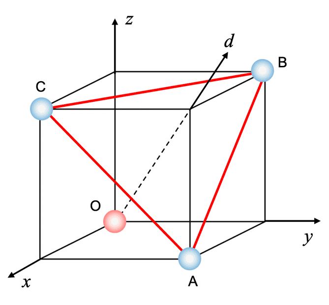

I took the straightforward approach and considered finding the tension on one of the balls (call it ball A) at the base of the tetrahedron by demanding that the sum of all the forces acting on it be zero. Since there is no friction, all forces are normal to the surface of the ball. Excepted is the force of gravity which acts at the center of ball A.
Additional forces are the normal force from the floor on which the ornament rests, two tensions from balls B and C also resting on the floor and the center-to-center compression from the top ball O. The centers of the four balls can be placed at four corners of a cube as shown in the figure on the right. The red triangle is in the plane of the surface supporting the ornament.
The Cartesian coordinate system has its origin at the top ball O. This makes writing unit vectors very easy. Note that gravity points along the ##\{1,1,1\}## direction (cube diagonal ##d##.) Thus, in this system, the weight of any of the balls is $$\mathbf W=\frac{Mg}{\sqrt{3}}\{1,1,1\}.$$The procedure then would be to
  1. Write all the forces on O and demand that the sum be zero. This will yield the magnitude of the compression force ##f## in terms of the weight ##W##;
  2. Write all the forces on A;
  3. Demand that the net force on A be zero. Although in 3D this means three equations, only two equations are independent because of the symmetry of the situation. These two equations yield the tension ##T## and the normal force ##N.##
It works and gives the expected answer. It is a good test of the method to solve for the normal force ##N## on one of the masses and verify that ##3N=4Mg##, i.e. that the total normal force exerted by the floor on the four-mass system is equal to the weight of the system.
