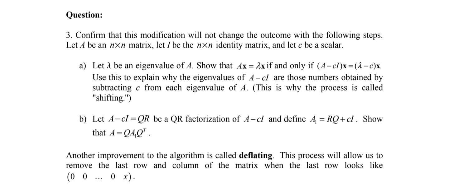

enogjini
Welcome to the forum. Have you tried simplifying $(A-cI)x=(\lambda-c)x$?
Please the forum rules https://mathhelpboards.com/help/forum_rules/, especially the "Show some effort" rule.
First. $\lambda$ is an eigenvalue of A if and only if there exist a vector, v, such that $Av= \lambda v$. Of course, for any vector v, Iv= v so for any number c, cIv= cv. Then $(A- cI)v= Av- cIv= \lambda v- cv= (\lambda- c)v$
