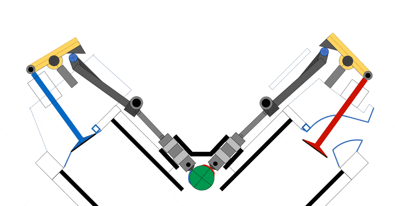

Unknowho
Has anyone else seen this valve train system? The claims I have read state it can rev higher than a OHC engine and out breath it as well due to the valve remaining at peak lift for up to 120 crankshaft degrees. Thanks

Hmmmm. I don’t understand what advantage there is to be gained from this valve actuation approach. Seems like a more complicated approach than your traditional pushrod setup, only with more inertia and lash.

Compared to a conventional pushrod valve train, this concept:
1) Has higher peak force on the cam. Cam lobes are already a weak point.
AND
2) Pushrod is loaded in bending, so both inertia and stress are higher.
AND
3) The pivot bearing is highly loaded.
AND
4) More parts and failure modes than a pushrod engine, so more expensive and less reliable.
Because of the inertia and bending, it is not possible for this design to rev higher than an OHC engine, or even higher than a pushrod engine.
How so, the rocker that is actuated by the pushrod pivots away from the fulcrum of the rocker that interfaces with the valve. This would reduce the rocker arm ratio thus reducing the torque needed to open the valve.
The pushrod is only around 2.5" long and only move the same distance as the cam lobe which is .08" The response to answer one addresses your stress statement.
The pivot bearing load does not exceed the spring pressure at peak lift due to the pushrod rocker bringing the valve rocker to a 1:1 ratio.
A DOHC coyote has 4 more cams and double the valves, springs, lash adjusters, locks, retainers and it does NOT face any reliability issues.
You might want to go and study COMPOUND LEVERS for a refresher to arrive at a logical conclusion.

Unknowho said:
Notice the camshaft lobe is very, very small.
Yes, but notice also that the "primary" rocker has an insanely huge ratio. The end of that rocker also applies force laterally and longitudinally. I suspect a force analysis on this part might show that it requires stronger and/or bigger parts than expected. So the "potential for lighter components" claim seems to be an illusion.
I'm also doubting the "increased valve lift" claim. I'm pretty sure the valve motion itself - together with the spring force maybe - is the limiting factor for the maximum valve lift in the current valvetrain designs.
The "reduced friction" claim is also hard to believe with adding more parts interacting together.

As I understand it, the main point of this idea is to reduce the height of the cams. This is important when operating at high rotational speeds. If the cam is too high, the pusher will not be able to return to the lower position at high rotation speed. The use of a low-altitude cam naturally necessitates the use of a lever mechanism to convert force into distance. It seems to me that in general this is a good idea. At the same time, of course, as the participants wrote earlier, there are problems with backlash, loads and friction. However, these problems can probably be solved by using suitable materials and the design of the mechanism.

The fact that the cam lobe is only .08" of lift enables the lobe to be ground with a base circle on it. This means the lobe can be ground to stay at the peak lift for up to 120 crankshaft degrees. It's not difficult to understand. Imagine you take a typical camshaft lobe which has a LCA (Lobe Centerline Angle). Then you mill it down from the opening ramp to the closing ramp at .08" of lobe lift.
Not that simple.
Let's do some back-of-the-envelope calculations.
Say your peak valve lift is 0.600", and with your typical cam, you reach it in 120 crankshaft degrees, and then the valve goes back to its seat in another 120 crankshaft degrees, for a total of 240 crankshaft degrees from seat-to-seat.
The average valve speed is ##\frac{0.600\text{ in}}{120\text{ deg}} = 0.005\text{ in/deg}##.
Since we know the speed when the valve is seated and when it is at maximum lift is zero, there is some peak velocity somewhere between those points. This will depend on your cam design, but it should be somewhere in the middle at around twice the average velocity, so ##0.010\text{ in/deg}##.
Therefore the average acceleration - not peak - from the seated position to half the peak lift is ##\frac{0.010\text{ in/deg}}{60\text{ deg}} = 0.00017\text{ in/deg/deg}##.
For your cam which keeps the valve at peak lift for 120 crankshaft degrees, you take 60° to reach peak valve lift of 0.600", then 120° idling at that position, and then another 60° to go back to its seat, still for a total of 240° from seat-to-seat.
Now, your average valve speed is doubled, thus also your peak velocity, now at ##0.020\text{ in/deg}##. So your average acceleration of the valve is now ##\frac{0.020\text{ in/deg}}{30\text{ deg}} = 0.00067\text{ in/deg/deg}##, i.e. 4 times larger than with a conventional valvetrain.
Assuming you do this, you will require a much, much stronger spring to fight back against this now 4 times greater inertia, which will throw away all the gains you think you've made elsewhere.
With a lever, whatever you gain on one side, you lose on the other.
Compare the position/velocity/acceleration/jerk curves of your design to the ones from a classical valvetrain design and you will be most likely deceived.

Too much hand waving, and not enough calculations (except for @jack action in Post #14) in this thread. To @Unknowho, it's time for you to do some calculations to support your ideas. Start at the valve, and define the position, velocity, and acceleration curves for the valve at the maximum engine RPM. Simplify the problem for now by looking only at the peak acceleration opening the valve. Then proceed as follows:
1) Including the valve spring force, calculate the force between the valve and rocker arm.
2) Calculate the inertia and angular acceleration of the rocker arm.
3) Calculate the force to accelerate the rocker arm and valve and compress the valve spring.
4) Calculate the force between the rocking pushrod and rocker arm. It will be larger than the force in Step 2 because of the ramp angle.
5) Calculate the bending moment on the rocking pushrod.
6) Calculate a cross section for the rocking pushrod using realistic materials and working stress.
7) Calculate the torque needed to accelerate the rocking pushrod plus deliver the force to the ramp on the rocker arm.
8) Go back to Step 5 and iterate including the angular inertia of the rocking pushrod. Repeat until the rocking pushrod is strong enough to deliver the necessary force to the rocker arm.
9) Now that you have the torque at the pivot of the rocking pushrod, you can calculate the force from the linear pushrod and the size of the pivot bearing. This might require going back to Step 5 and iterating again.
10) The force on the cam follower is the force from Step 9 plus the inertia of the linear pushrod.
11) Compare the force on the cam follower of your design to that of a standard pushrod engine with the same valves and valve motion profile.
At this point, you have completed the concept design. If it looks good, you can proceed with the actual design and refine the calculations starting from Step #1. This is the Mechanical Engineering forum, and this is how mechanical engineers look at ideas. No engineer would consider showing a concept design idea to management until the first pass of the above procedure through Step 11.
If you are truly interested in evaluating this idea, start by defining the valve motion profile as indicated above. I suggest that you use the motion profile from an existing engine. We can help you with this.
