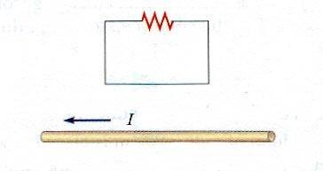

The drawing shows a wire loop near a current -carrying wire. Under what conditions would current flow through resistor R from Right to left?
Lenz's law
4 answers
a) when the current I is increasing
b)when the current I is constant
c)when the current I is decreasing
d)all of the above
I think its C but not sure
Why aren't you sure? What's your reasoning?
well I know according to Lenz's Law an induced current always flows in a direction that opposes the change that caused it. but with answer C it just decreasing but not heading in the opposite direction so I was not sure
The magnetic field from the current points into the loop (into the page). Since it's decreasing, the change in flux is out of the page. (You've got it.)
