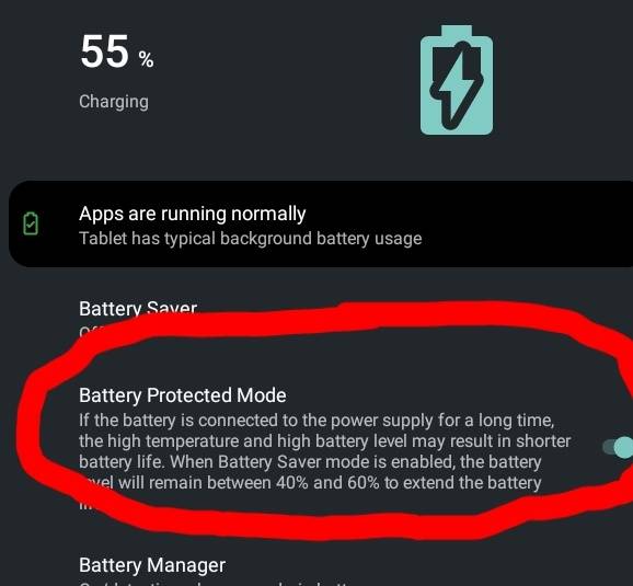

My new Lenovo tablet has a "battery protection mode". This is useful for example when you want to leave it on charge almost permanently, in which case the protection mode will charge and discharge between 40% and 60% in order to maximize battery life.
Is there an API that can enable/disable this mode?
Android battery settings screen showing 55% charging with a battery icon, a red circle around the Battery Protected Mode toggle, which is switched on, with its description text.
As far as I know, there is no public API for this. All Android APIs related to battery are read-only.
If your phone is rooted, then there are some Magisk modules that can do this. In addition, OEMs may have some hidden APIs that can do this, but that will be specific to each brand and not easily discoverable.
Different brands have different implementations of charge controller. Your device charges and discharges between 40 and 60%. Newer Samsung devices with OneUI can stop the charging at 85%, and restart it at around 83%. (My HP laptop stops charging at 80% and trickle charges thereafter.)

While searching on this topic, I found a suggestion that one can use if one is OK with an extra external device. You can use a WiFi controlled smart mains socket that can be commanded ON / OFF by an app running on your phone. Charge through that socket, and let the app do all the logic.
