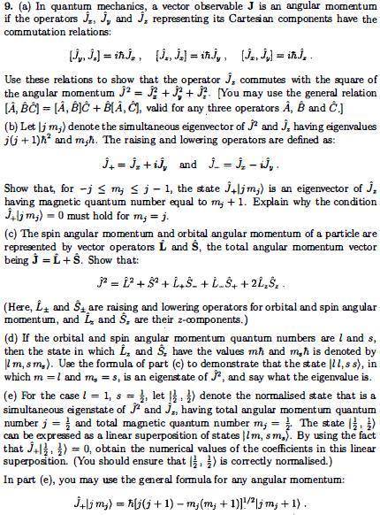

Part (e) of the attached question. Sorry for using a picture, and thanks to anyone who can help.
the answer to part (d) is that the eigenvalue is
[tex]\hbar^{2}\left(l\left(l+1\right) + s\left(s+1\right)+2m_{l}m_{s}\right)[/tex]
where, for this part of the question, [tex]m_{l}=l[/tex] and [tex]m_{s}=s[/tex].
I try to expand the state [tex]\left|1/2,1/2\right\rangle[/tex] in [tex]\left|l m_{l}, s m_{s}\right\rangle[/tex] but would I need six components (and therefore six coefficients)?
Because we have [tex]l=1[/tex] then [tex]m_{l}=1,0,-1[/tex] and for each of those we can have [tex]m_{s}=1/2,-1/2[/tex].
I can act with [tex]J^{2}[/tex] on this expansion and use the formula for the eigenvalues above, but then I still have 6 unknown coefficients.
If I expand the state as [tex]\left|j,m_{j}\right\rangle[/tex] then there are four components for [tex]m_{j}=3/2,1/2,-1/2,-3/2[/tex].
Acting with [tex]J_{+}[/tex] on rids me of the first term but I still have 3 unknowns.
The last equation I haven't used yet is the normalisation of the coefficients but so far I have too many unknowns for it to be useful.
Thanks very much to any helpers, really not sure where to go with this one..

For part (d), you should be able to show that the expression you have is equal to [itex]\hbar^2j(j+1)[/itex] where j=l+s.
For part (e), considering just the z-component, you have Jz=Lz+Sz. Use this fact to cut down on the number of |l ml; s ms> states you have to consider.
