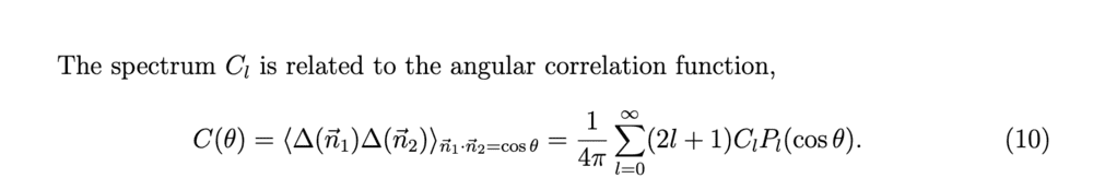

@kimbyd .Thanks for your quick answer.
I have looked at your paper and notice that passing :
From what you seem to say, the ##C(\theta)## on the left would represent the angular correlation function, wouldn't it ?
and in the right term member would appear ##C_{\ell}## which would be the Angular Power spectrum ?
If this is the case, How could I express ##C_{\ell}## from ##C(\theta)##.
Your help will be precious, thanks in advance.
Equation 10 there is a reversible transformation. The orthogonality condition is described here:
https://en.wikipedia.org/wiki/Legendre_polynomials#Orthogonality_and_completeness
There's a notational difference there, in part driven by the argument being ##x## rather than ##cos(\theta)##, but it shouldn't be too difficult to take a simple example (e.g. ##P_1##), do the integrals manually, and see what the normalization factor needs to be.
