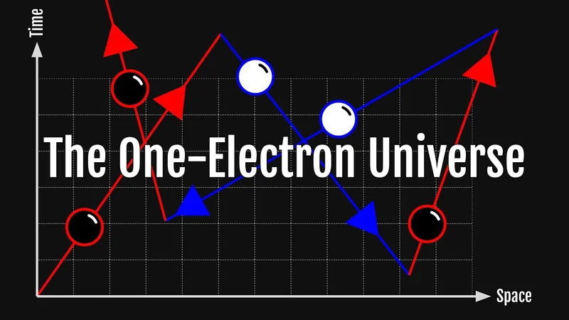

The one-electron universe is the hypothesis that all electrons and positrons are actually manifestations of a single entity moving backwards and forwards in time. It was proposed by theoretical physicist John Wheeler in a telephone call to Richard Feynman in the spring of 1940.
The idea is based on the world lines traced out across spacetime by every electron. Rather than have myriad such lines, Wheeler suggested that they could all be parts of one single line like a huge tangled knot, traced out by the one electron. Any given moment in time is represented by a slice across spacetime, and would meet the knotted line a great many times. Each such meeting point represents a real electron at that moment.
At those points, half the lines will be directed forward in time and half will have looped round and be directed backwards. Wheeler suggested that these backwards sections appeared as the antiparticle to the electron, the positron.
My Question is that the reasoning given by Feynman that many more electrons have been observed than positrons, and electrons are thought to comfortably outnumber them, seems insufficient to me for rejecting a beautiful hypothesis like this as evidently Feynman arrived at a defining conclution that antiparticles could be represented by reversed world lines, and credits this to Wheeler, saying in his Nobel speech - "I took the observation that positrons could simply be represented as electrons going from the future to the past in a back section of their world lines. That, I stole!" shown enough result that Wheelers hypothesis wasn't vague or random at all! So why wasn't any attempts made in reconsidering his predictions? And how does the fundamental nature of electrons change when they travel backwards in time ?
That's true, but that hypothesis is not the same as Wheeler's "one electron" hypothesis.
In quantum field theory--or more precisely, when doing perturbation theory in QFT--we do represent antiparticles as lines in Feynman diagrams with their arrows "going the other way", so to speak. So that is no longer a hypothesis, it's part of how we do QFT. (Note that there are limitations to this point of view, which is why I specified that it's used when doing perturbation theory.)
Wheeler's "one electron" hypothesis, however, remains just a hypothesis, with the obvious argument against it that Feynman gave, which you describe. But that is only an argument against the "one electron" hypothesis; it is not an argument against the more general claim that we can describe antiparticles, under suitable conditions, as particles with their lines "going the other way".
Also was there any substance to the thought of world lines being represented as knots in Wheelers explaination?
I don't know that that was even part of Wheeler's hypothesis; the word "knots" was yours, not Wheeler's.
yeah i got your explanation only thing is that i took the word from the wiki page that i linked in my question so if anything i think the author of the page made a mistake not me adding to the hypothesis... 😆😅
Ah, ok. Yes, I would not trust the Wikipedia page's description of the actual details of the hypothesis.
  • Agree

Roberto Pavani said:
I'm not sure I fully understand the one-electron hypothesis
Unfortunately, as I've already pointed out, it's often confused with modeling antiparticles as particles with arrows in Feynman diagrams that go the other way. Even the Wikipedia article referenced earlier has this confusion.
As far as I know, Wheeler never formally published his "there is only one electron" idea; he only brought it up in an informal conversation with Feynman. Feynman later recalled this conversation in his 1965 Nobel Prize acceptance speech. There is no indication that Wheeler intended the "one electron" idea to be taken seriously as a scientific hypothesis; as I said in post #4, all the indications are that it was just a typical whimsical suggestion by Wheeler.
Under CPT, at each time-reversal the spin flips: e⁻ up → e⁺ down → e⁻ up → e⁺ down → ...
But then all forward-going segments have spin up and all backward-going segments have spin down. Where does an e⁻ with spin down come from? Does it require a separate chain?
If Wheeler had tried to publish his "one electron" idea as an actual formal scientific hypothesis, this would have been just one of many obvious problems with it. Another such has already been pointed out earlier in the thread. But he never tried to actually publish it, so it never reached the point where anyone took the time to work through such things.
