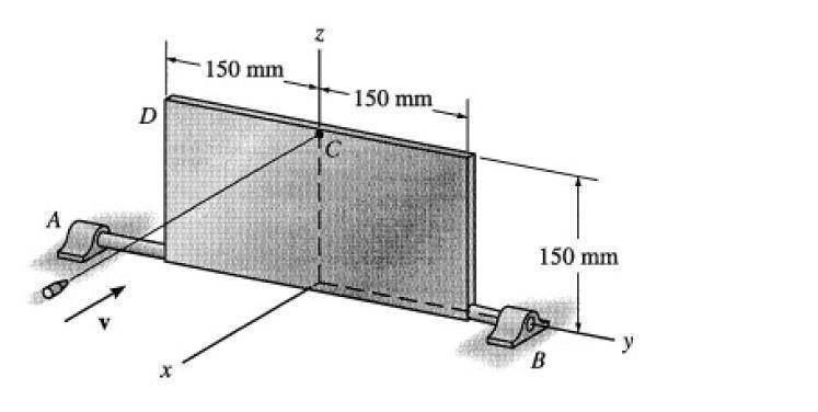

The 15kg plate shown above is able to roate on its axle which is supported on the the journal bearings at A and B. A bullet is fired into the plate providing it with an initial angular momentum of 9kgm/s. Find the angular velocity of the plate when it has rotated thropugh 180 degrees from the postion shown. Neglect the mass of the bullet.
Moment of Inertia of a Plate = [tex]\frac{1}{3} \times Mass \times width^2[/tex]
[tex]L = I \omega[/tex]
Then I'm not sure, some equations I know for rotation about a fixed axis are:
[tex]\Sigma F_{n}=m\omega^2 r_{g}[/tex]
[tex]\Sigma F_{t}=m\alpha r_{g}[/tex]
[tex]\Sigma M_{g}=I_{G}\alpha[/tex]
I calculated I as 0.1125 [tex]kgm^{2}...[/tex] ([tex]\frac{1}{3} \times 15 \times 0.15^{2}[/tex])
so using [tex]\omega= \frac{L}{I}[/tex] this gives me a [tex]\omega[/tex] of 80... however I'm not sure what the units as both 80 rad s^-1 and 80ms^-1 seem unreasonable. I am also unsure how to calulate [tex]\alpha[/tex].

Welcome to PF Alex,
It would be useful if you could post your diagram, then I can verify you moment of inertia.
Image 'Pending Approval'. Sorry I accidently press post (rather than preview) before I had finished and sorry about some of the dodgy latexing as I've never used it before.
diagram of plate now viewable
Nope, 80 rad/s sounds good to me. All your working is correct thus far, now all you need to do is determine the torque about the y-axis.
HINT: It may be useful to introduce an angular variable measuring the angle between the plate and the z-axis.

All good :approve:. Can you now write the torque in terms of the angular variable?
HINT: The only force creating a torque about the y-axis is the weight of the lamina.

You can't solve the ODE yet since the torque is a function of the angular variable, [itex]\tau = \tau(\theta)[/itex]. Therefore, as I said in my previous post, you need to determine the net torque about the y-axis in terms of the plate's weight and [itex]\theta[/itex] before you can proceed.
Edit: In actual fact you're never going to have to solve and ODE since [itex]\alpha = \dot{\omega}=\boldmath{\ddot{\theta}}[/itex], which is what you wish to determine.

You're almost correct, but your missing one vital piece of information. What is the definition of torque?
yes I'm missing the distance at which the force acts, I'm assuming this is the plates centre of gravity... Thanks for all your help!
Correct, so your torque is,
[tex]\tau = -0.075mg\sin\theta\left(\underline{j}\right)[/tex]
And adding the vector notation to your previous answer,
[tex]\tau = I \frac{d^2 \theta}{dt^2}\left(-\underline{j}\right)[/tex]
So can you finish the question off yourself?

You can't integrate directly, because (as you say) that will give you the total torque throughout the rotation from 0 to [itex]\pi[/itex], which isn't very useful. Remember what our goal is, the question wants the angular velocity after a given angle of rotation. Therefore, we should be aiming to write the angular velocity as a function of [itex]\theta[/itex].
When I said that you won't have to solve a second order ODE, it may have been misleading. You will have to solve an ODE, but there is a nice trick that we can do to make it a little easier. So I'll make a start for you, if we equate the two equation we have for torque we obtain,
[tex]I\ddot{\theta} = 0.075mg\sin\theta[/tex]
Where the dots represent time derivatives. Now collecting the constants,
[tex]\ddot{\theta} = A\sin\theta\hspace{2cm}\left(*\right)[/tex]
So we have the second time derivative of the angular variable is equal to some function of theta. Keep in mind that we want [itex]\omega\left(\theta\right) = \dot{\theta}\left(\theta\right)[/itex], this is where a little trick comes in handy.
Using the chain rule consider (noting that [itex]\theta = \theta\left(t\right)[/itex]),
[tex]\frac{d}{d\theta}\left(\dot{\theta}\right)^2 = \frac{d}{dt}\left(\dot{\theta}^2\right)\frac{dt}{d\theta}[/tex]
Once again applying the chain rule to the first differential,
[tex]\frac{d}{d\theta}\left(\dot{\theta}\right)^2 = 2\dot{\theta}\frac{d}{dt}\left(\dot{\theta}\right)\frac{dt}{d\theta} = 2\dot{\theta}\ddot{\theta}\frac{1}{\dot{\theta}}[/tex]
We cancel the [itex]\dot{\theta}[/itex] and divide by two to obtain,
[tex]\ddot\theta = \frac{1}{2}\frac{d}{d\theta}\left(\dot\theta^2\right)[/tex]
Hence (*) can be re-written,
[tex]\frac{1}{2}\frac{d}{d\theta}\left(\dot\theta^2\right) = A\sin\theta[/tex]
Do you follow? Can you now take the next step?

I haven't checked your arithmetic, but your method looks good. The only correction I can see is that your angular velocity should be in the (-j) direction (using the right hand rule). The chain rule 'trick' is definitely a good one to know and the method of introducing an angular variable is also good to remember, especially in rotational motion.
Anyway good job on your solution :approve:

Nope, you're not missing anything. Conservation of energy (after the collision) is equally applicable here, it is merely my personal preference to work with conservation of momentum rather than energy. However, note that conservation of momentum is required to determine the initial angular momentum/velocity of the plate. Of course, in both approaches we ignore the frictional torque at the journal bearings.
