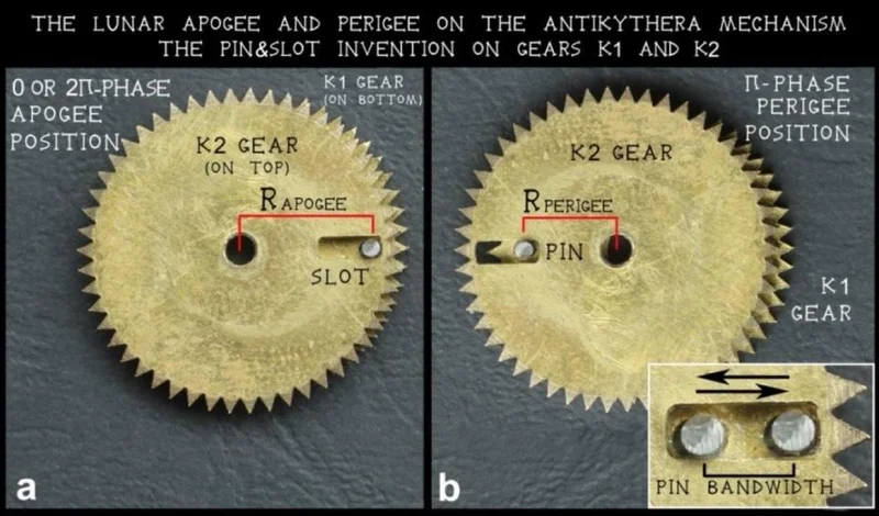

There were some interesting gears in the device. In particular, one gear slipped back and forth to handle the lunar anomaly. Gears were hand-cut, introducing tiny errors into the calculation. Probably needed to reset from time to time.

Two photos of brass gears from the Antikythera mechanism showing the pin-and-slot arrangement for lunar apogee and perigee; a shows the K2 gear on top with pin and slot, b shows the pin at the perigee position with bandwidth detail inset.
