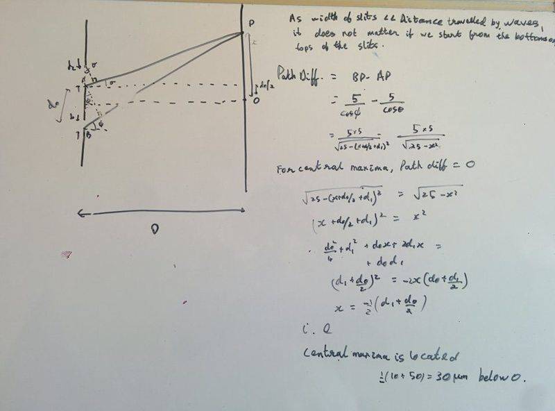

I like the first one. I've attempted to get the central maxima:d1=10microns, d2 = 20 microns and do= 100 microns. I'm not entirely sure its right though. But its a good sum, I'm enjoying doing this.
Actually, hold on a bit, I think I know what I did wrong . messed up the trigonometry big time, just ignore that .

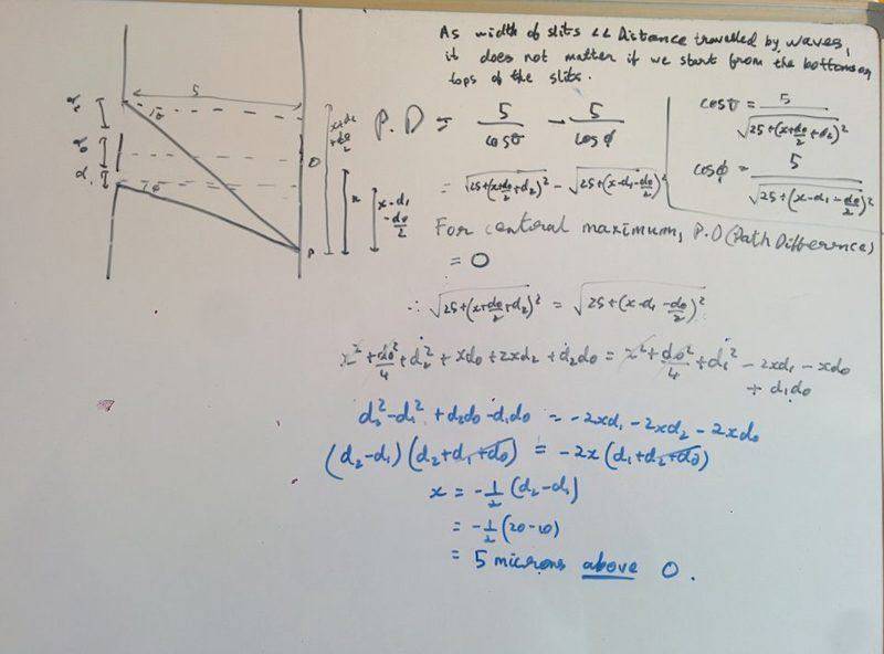

This I think is the right one:
